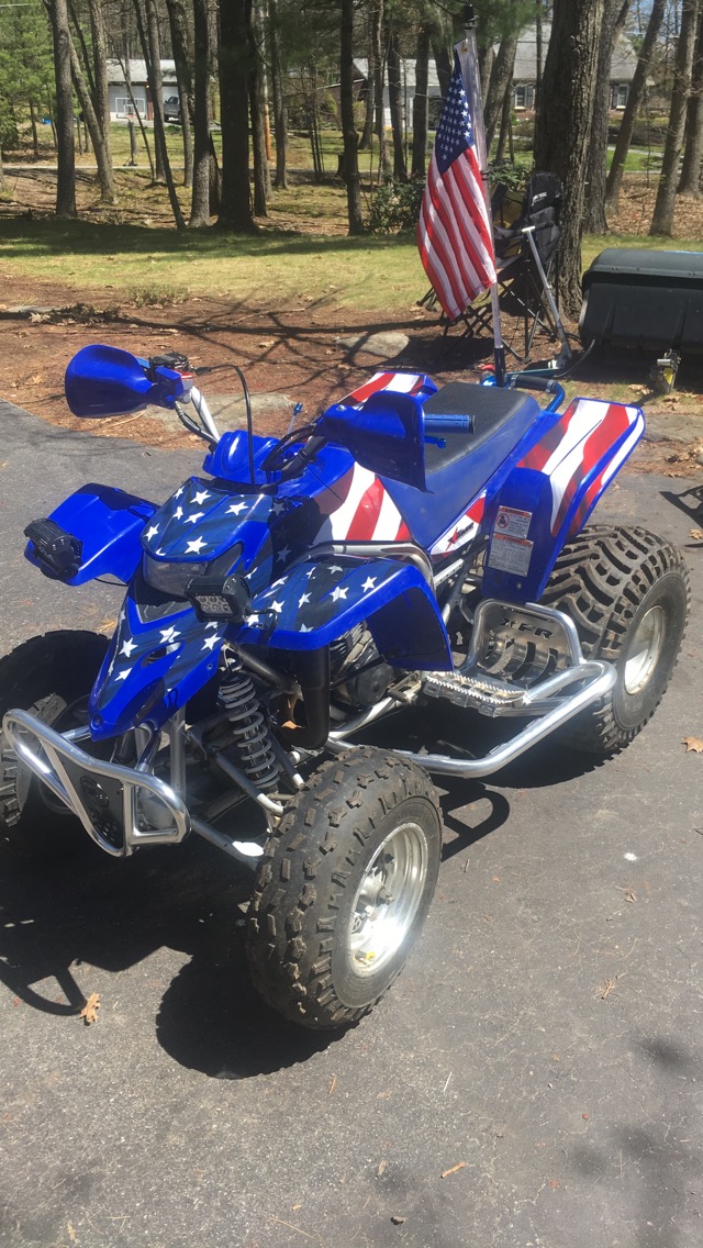

    I can’t speak on whether those tires will fit on those rims but My rear rims are Yamaha 8’s and I have 22x11-8’s on there. They spin just fine and it pops a wheelie no problem. Stock swing arm length and no mods
    I am doing a full rebuild though and getting a +3 swing arm and getting banshee hubs. If you want a better selection it wouldn’t be a bad idea to go banshee setup at somepoint too. Fronts are universal on Yamaha and better selection for a full set of banshee rims and tires
