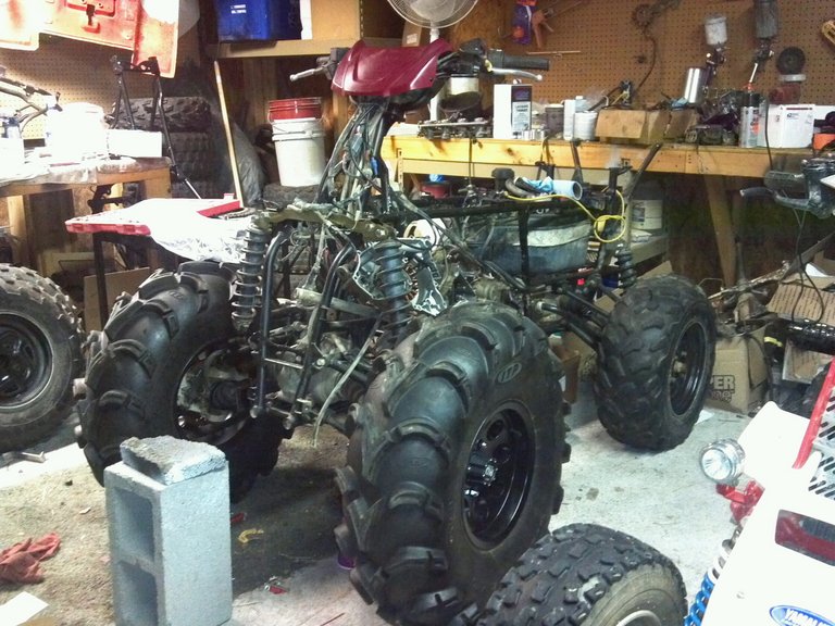

im dreading putting the 4 stroke motor together. we are just waiting for the timing chains and tensioners and lower rod bearings to come in to start assembly. hopefully everything goes well...

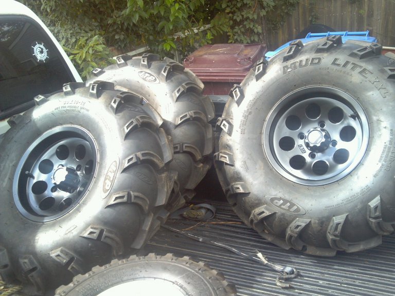

tires are mounted on the rims

i been out playin with the brute tonight. seems like the wheel spacers that high lifter sold us dont work. not quite the right size. we did get most all the timing and oil pump chains and tensioners installed though as well as the new rod bearings. now i need to find a torq wrench that will fit in there to get them snug and go get the new valve springs installed so we can put the heads on. we went ahead and put the front tires on to see how it looked. 16 1/2 inches of clearance!!

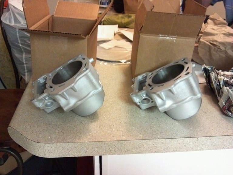

ran into some problems... the pw clearance is to large and i caught in when i was doin the ring end gaps. looks like we will need to send them to millinium for a strip and replate of the nikasil.

i did some research and some guys stick with the stock belt but if we have trouble ill be sure to post here and get a more expensive one. the cylinders should be back on friday with fresh nikasil and i should be ready to finish putting the motor together once i get home. hopefully this machine will make it to busco, but it will be pushing it. mainly my brother is pushing it. i just ordered some diff and output shaft seals. well see what happens i guess...
