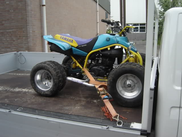

baught a yamaha blaster;

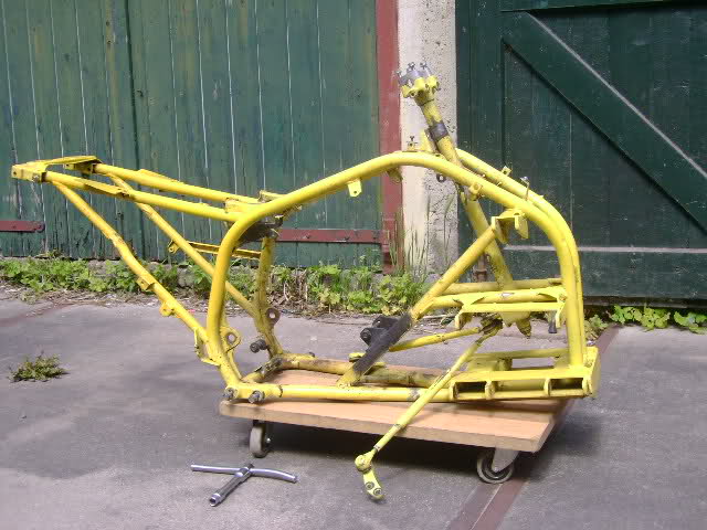

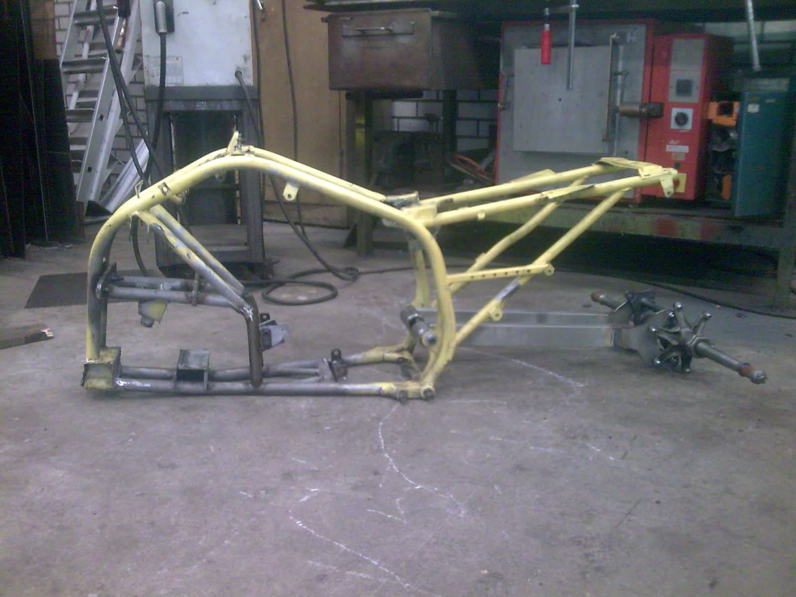

2nd day already stript;

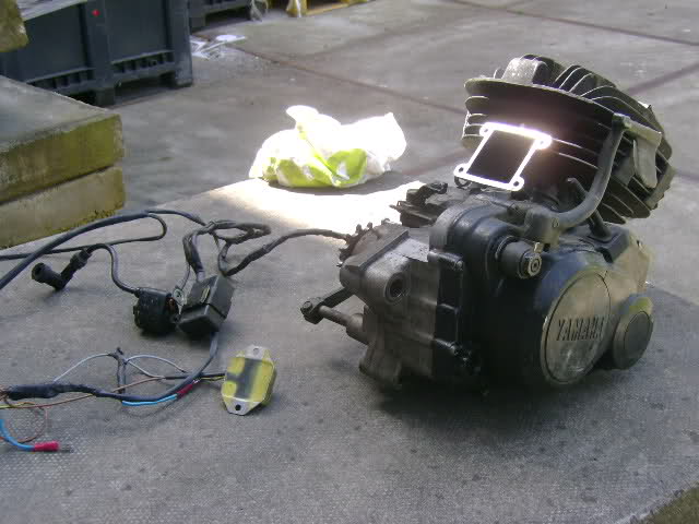

the blaster 200 has to go

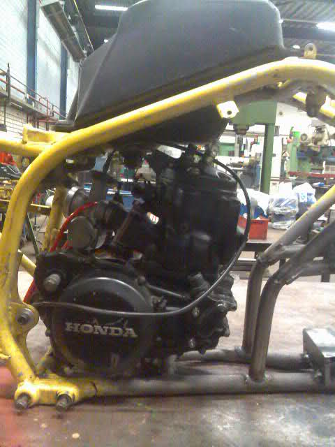

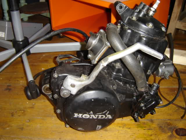

because i had a cr500 engine

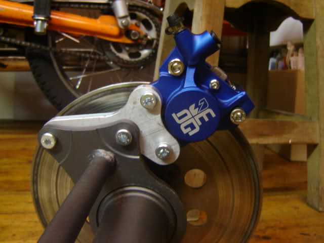

new shocks
new disc brakes
new hydrolic rearbrake
engine on place

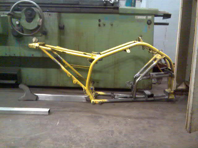

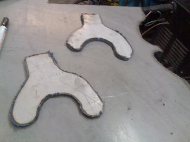

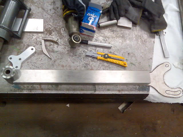

progres rear swing
cut out rearshit whit thermoshit
give it a good shape
try for the looks, gonna be a long one
weld it up
together

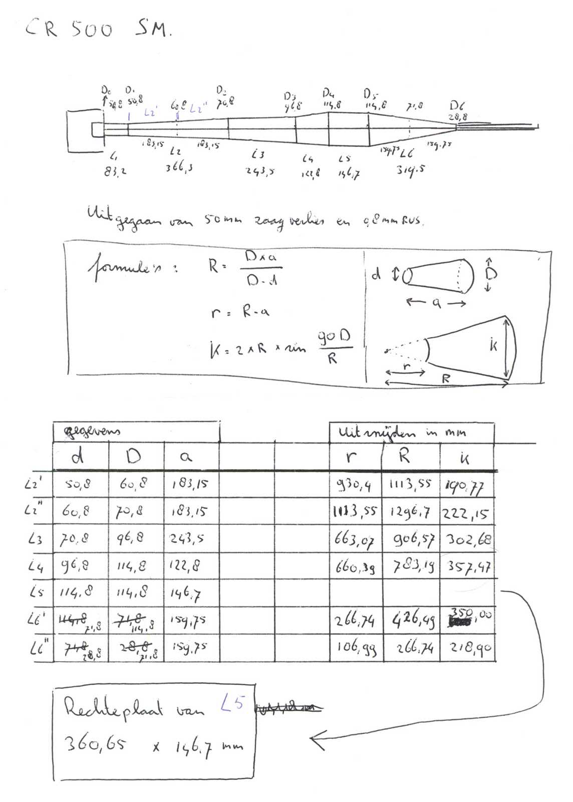

exhaust calculation
ill keep u update

jesus christ. hey man dont laugh, i just had a feeling 4 because its a f*cking 500. is this engine for another dirtbike or is it a streetbike engine or something?
hehe, nice welcome of you guys.
it is a cr500 2 stroke engine.
i used aluminium? adaptors for the engine so the vibrations are a little bit less.
the rest of the vibrations i have to catch whit my hands and ass.. I:I

rear swing is made by myself.
exhaust pipe is designd by a friend and me.
but my friend is more expert in welding exhaust so i leave it up to him.
i dont have the stock motor, its not gonna fit anymore.
if i want a stock blaster, i can better buy a new stock one.
