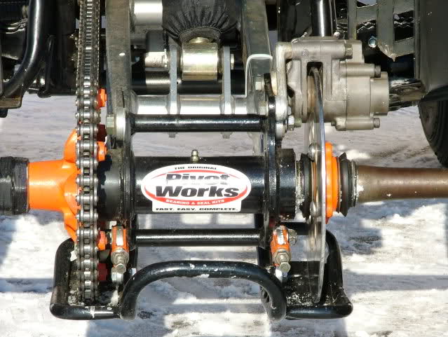

So before I posted this I read every thread I could find about removing an axle from the bearing carrier. I have tried all methods with no success. Currently I am using about a 14'' piece of 1" pipe centered against my left side hub and beating the hell out of it with a 5pound sledge.(IS THIS THE BEST WAY?) The bearing carrier is still mounted to the swinger should i remove it? No success I have used PB Blaster hell even had my GF out there to assist and that ended in a fight cause I was quickly losing my temper. So basically I am asking at what point do I give up..? As I don't want to destroy my hub, axle, or threads. So is there any chance I could destroy something from beating away or just keep beating? I have read where numerous peeps are having the same problems but never see them post that they finally got it out. P.S. It's a '95 blaster btw and I dont have a torch so any other basic ways of applying heat? Any answer will help or atleast give me a piece of mind! Thanks so much in advance!!

im thinking its behind the brake calliper tucked up in the edge of the carrier should be a little thin piece of metal going around the edge with 2 little tabs on the ends with holes in them you need to pull the holes towards each other and pull it out at the same time kinda a pain if you dont have the tool

a 2000 wont have a snap ring. as it stands you will need to replace the bearings and seals. the carrier will come off the sprocket side. first spray it with pb blaster of other penetrating oil and let it sit overnite. now take a torch, propane in thats all you have , pop out the seals and heat the bearing/axle on the sprocket side as hot as you can get it. place the axel upright with the endo on a big block of wood so you dont tweak the threads, sprocket side down and start smacking the brake side of the carrier driving the carrier down on the axle. it may take a few heat beat cycles but it will break free. when you put it back together grease all metal to metal contact points and take it apart and regrease once or twice a year so the problemn doesnt happen again.

hey man slow down a notch. one side of the axle has a raised spacer type deal and it will NOT go out that way. you've tried both sides right? i forget which side that spacers on but i know i tappedi t a few times, flipped it and when i flipped it it slid right off and it was because of that spacer that is part of the axle.

You should be able to take the caliper off the carrier, take both nuts off the axle and drive the axle out toward the brake side. Make sure the sprocket carrier is off too. There is a raised side of the axle where the seals ride on for the bearing carrier. It should come out. The spacer in the middle might be rusted to the axle but it will all come out..
