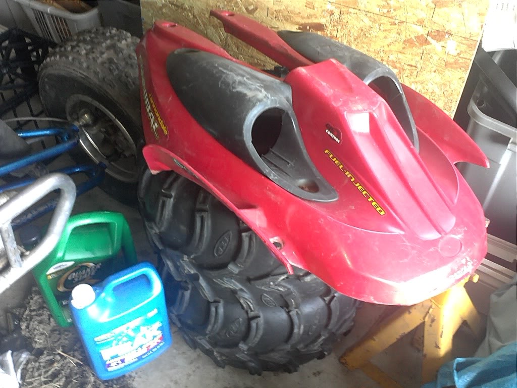

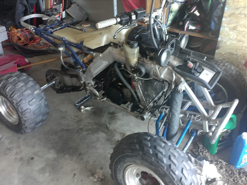

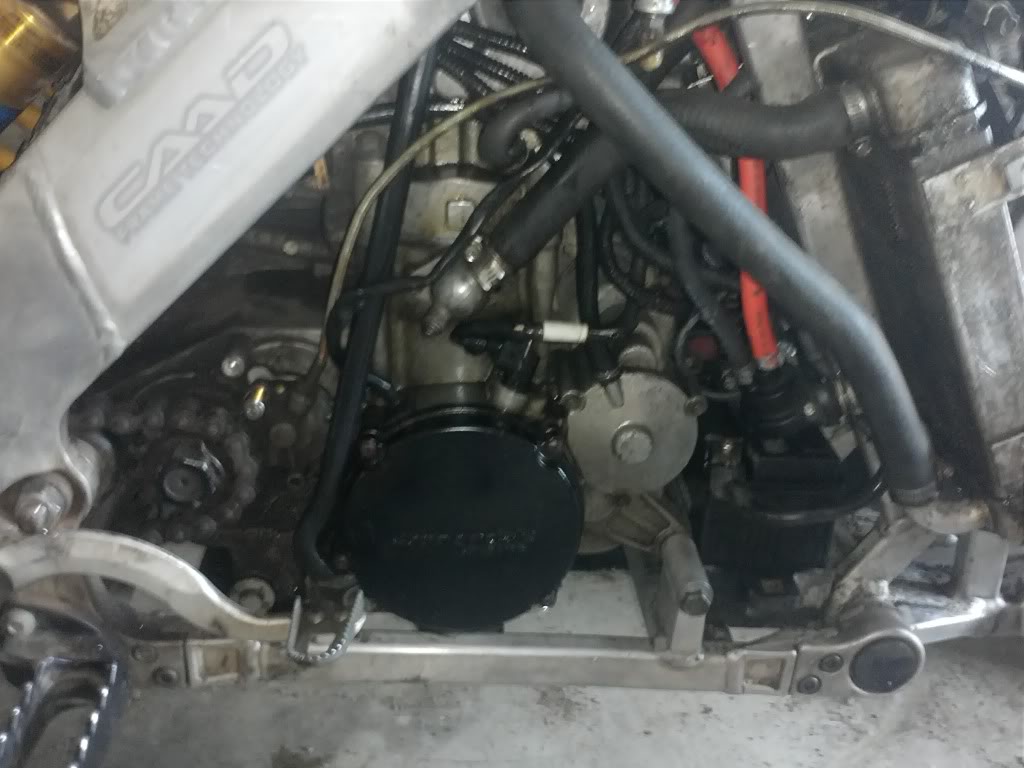

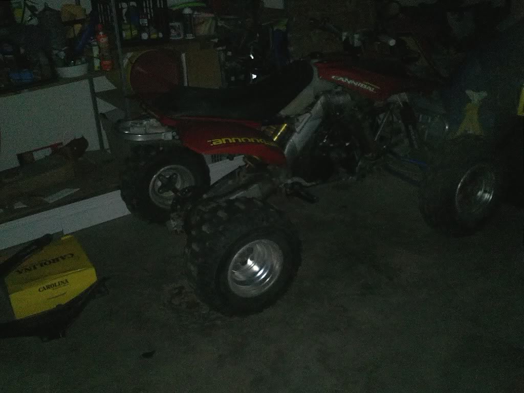

The last pic is with all the plastics on when I first got it home. As you can see from the motor pics its way more complicated than a blaster LOL. The Guy also threw in the brand new mud lites with the deal
