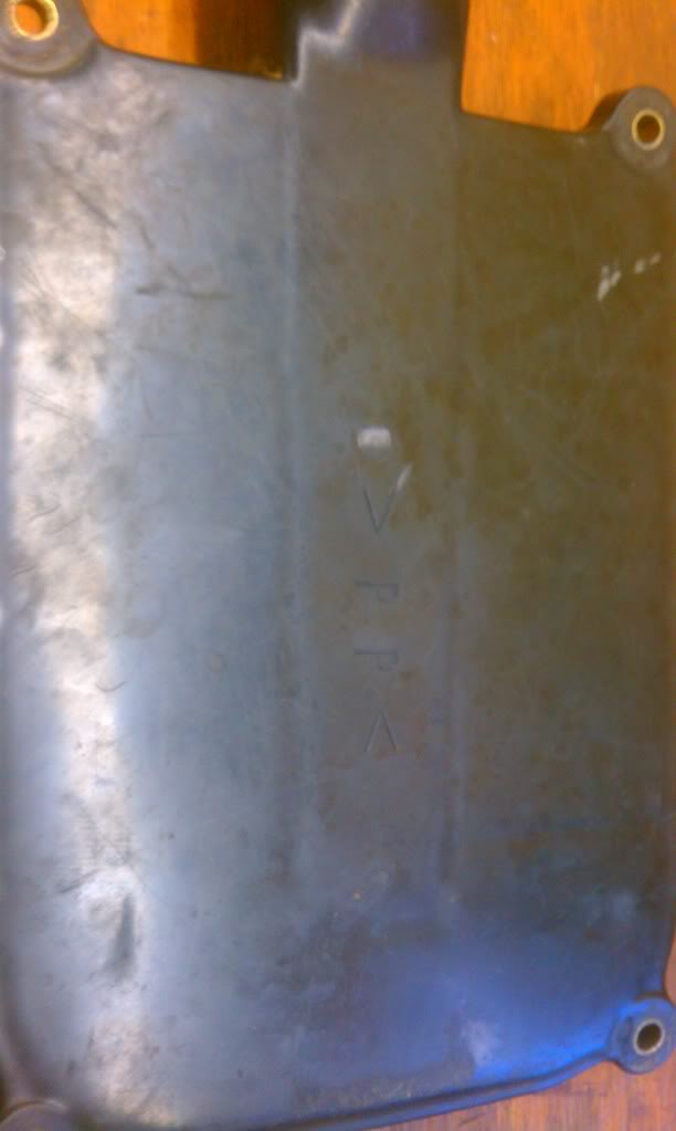

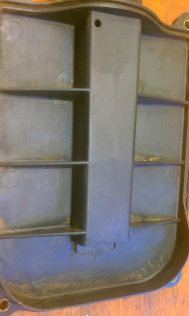

so i am wondering what size drill bit i have to use to drill a circle in the airbox lid to increase the airflow? also if i do this what else would i have to do to accommodate for it. heres some pics!
also if you could show me in paint where i would drill the wholes im thinking inbetween the squares?

Because there's supposed to be a valve on the hole you squeeze to let water out. Top area is somewhat protected by the seat. Most save the money for the vents and just remove the lid. Either way you must re-jet. More air=more fuel :D
