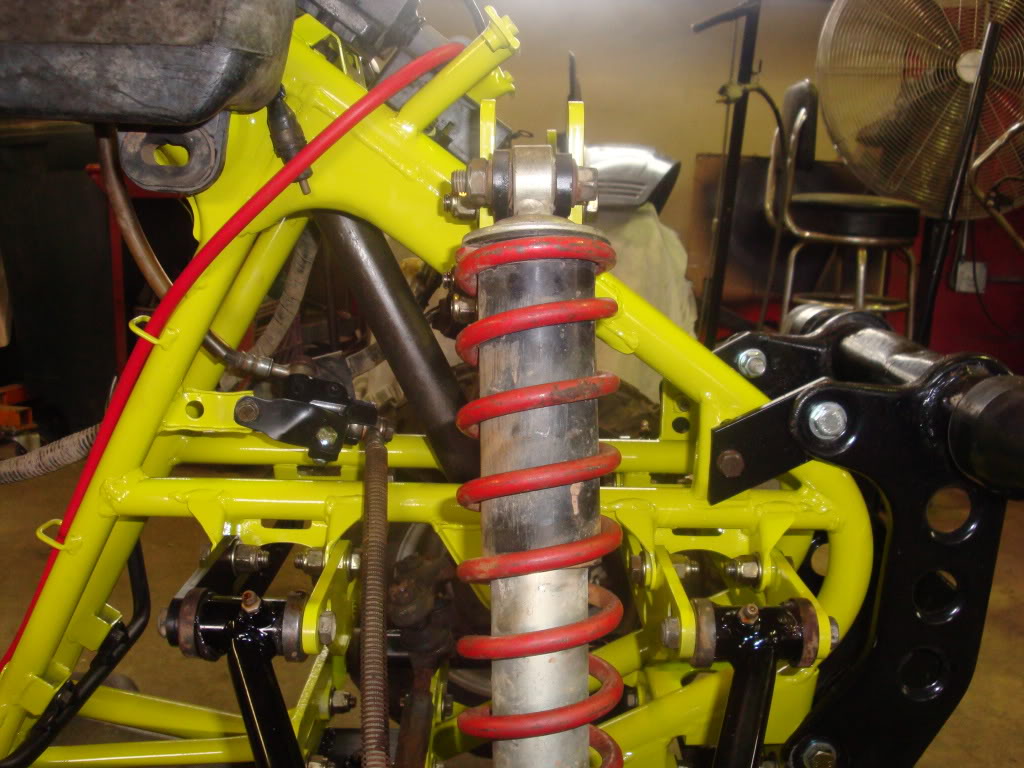

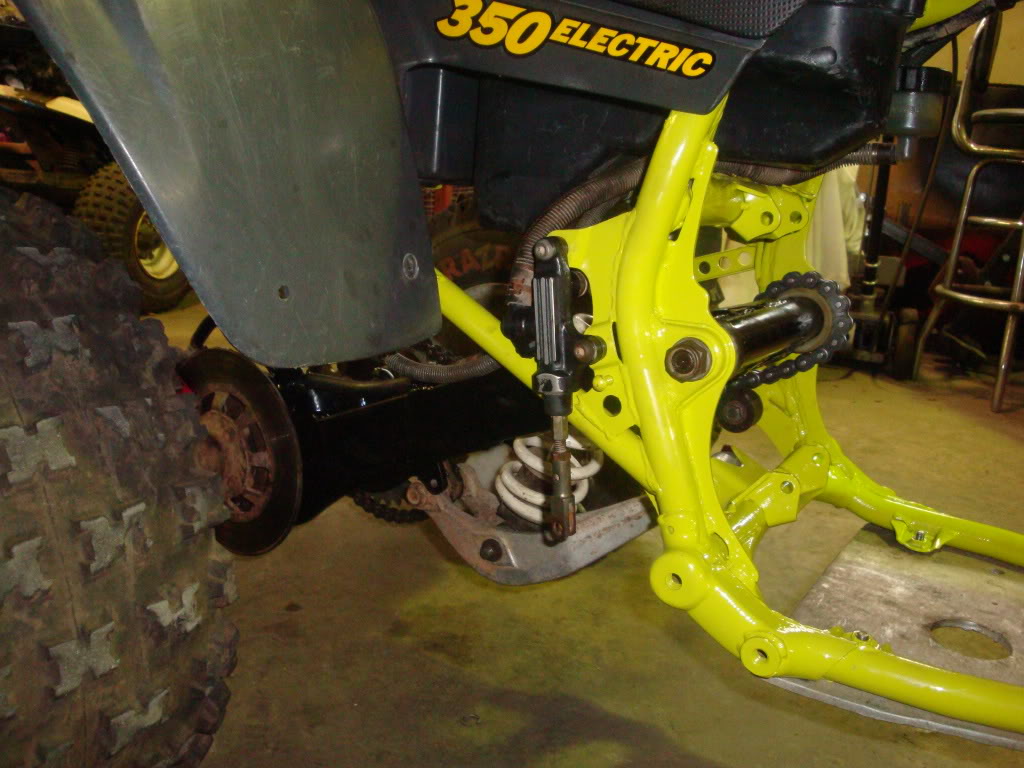

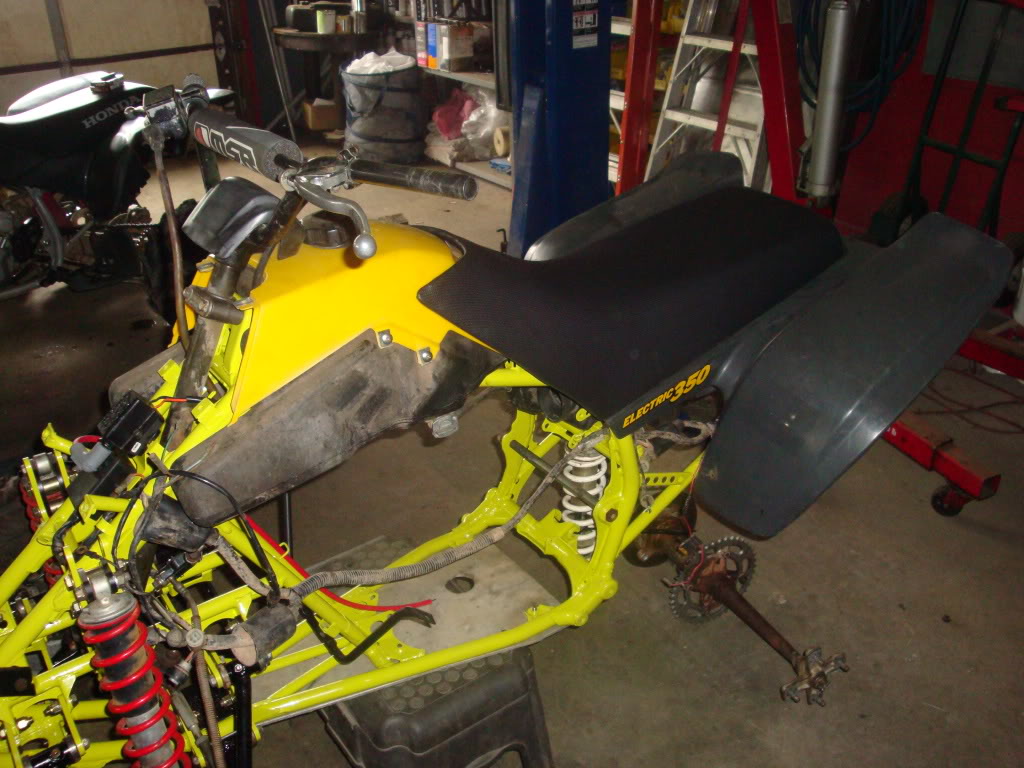

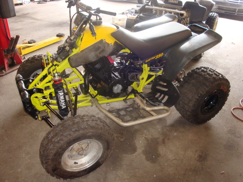

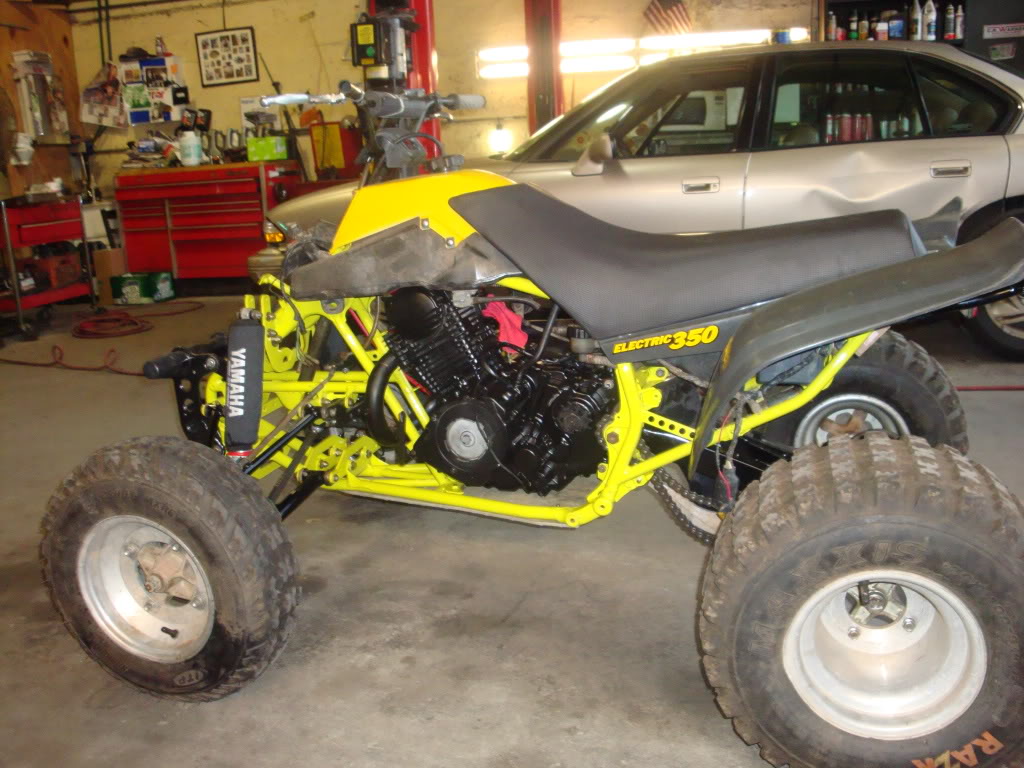

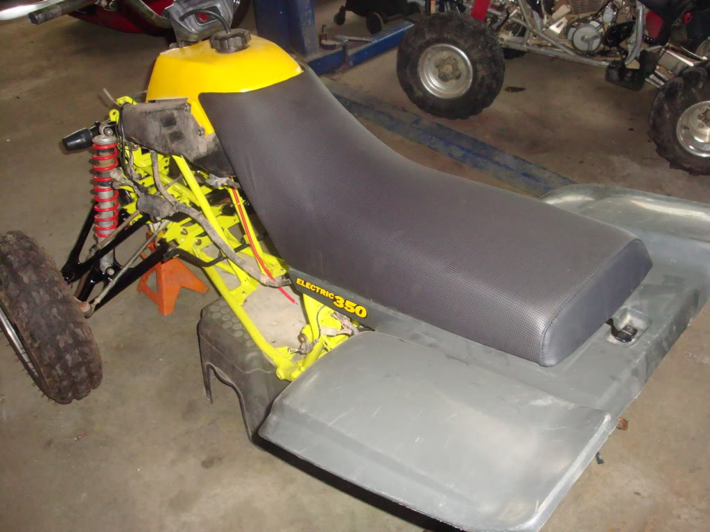

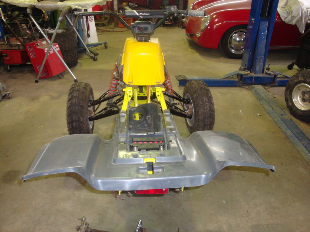

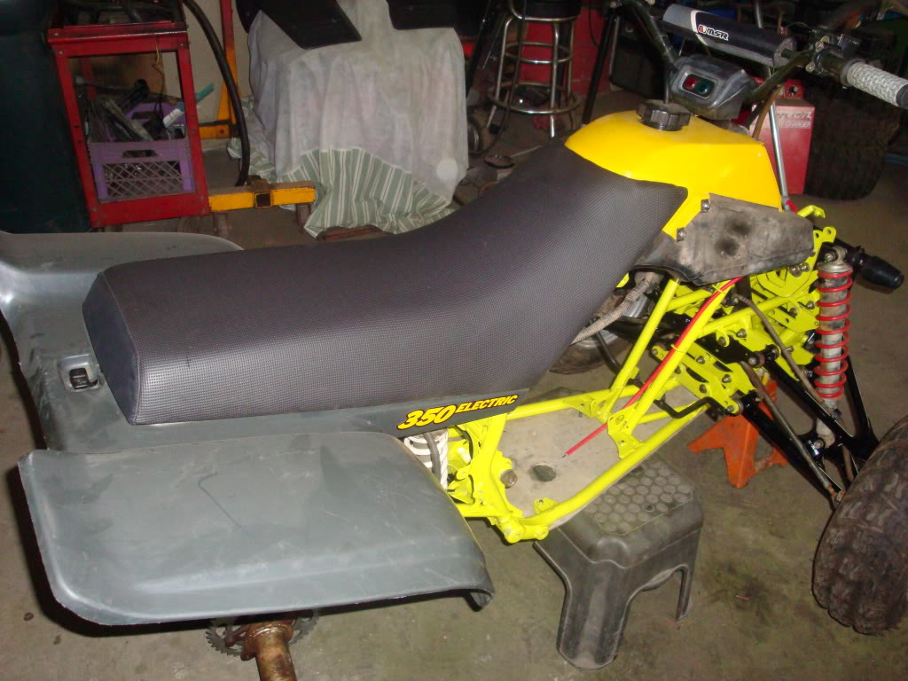

ok so I am building an 87 Warrior for my wife.
It was in running but poor shape. It was smoking like crazy and after disassemble we found .008 wear in the cylinder. So a new Weisco .020 piston is going in. The plastics were all cut for racing so we took them off and I have plastics from a 90-up style we are going to use. Also the headlight and taillights were gone so also we will use the 90-up ones. I know I will have to make a bracket to make the headlights fit but everything else looks like it will fit pretty well. The bike frame was blue, with blue & white plastics. I really should have taken a before picture. Anyway I will post up some new pics of what it looks like now.
Hopefully to be finished up in another week. Just waiting for some last parts to come.
I know it is not a Blaster, but at least it is a Yamaha

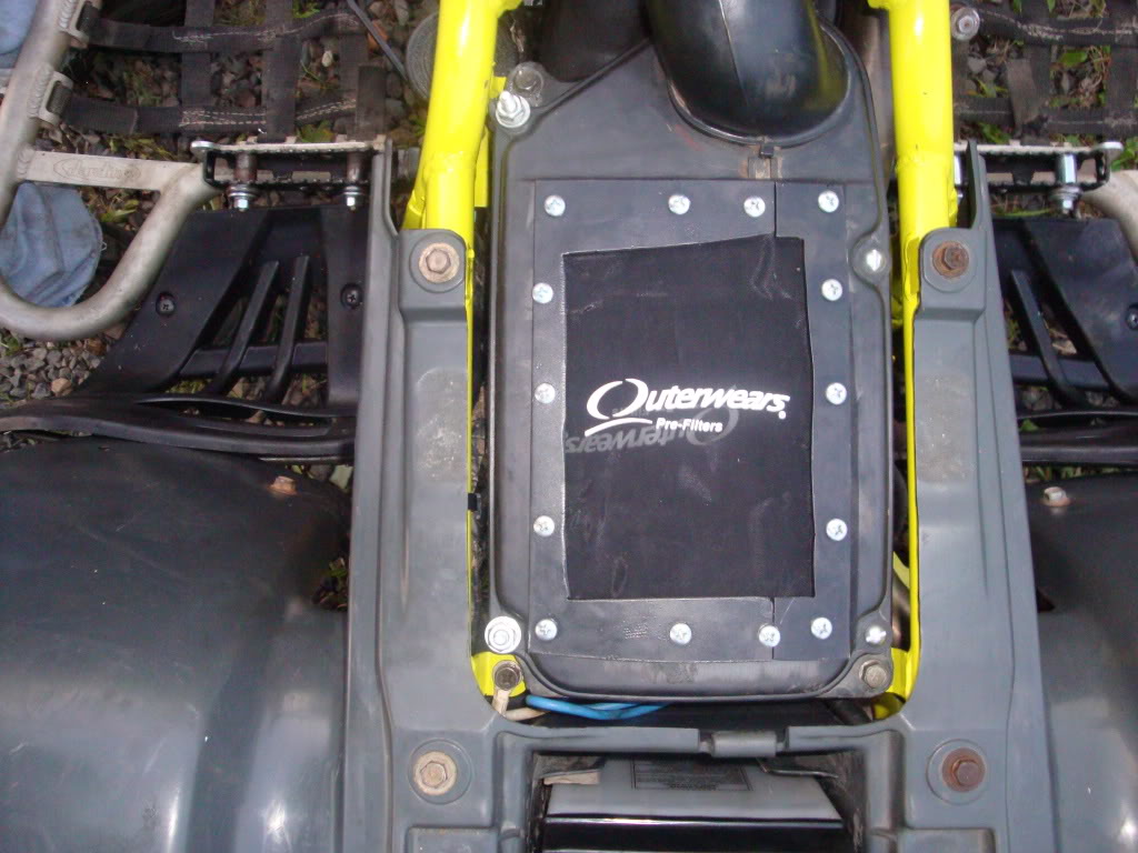

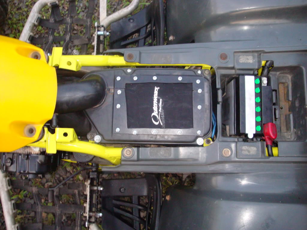

K&N Filter w/Outerwears
Custom Air Box Lid W/Outerwears

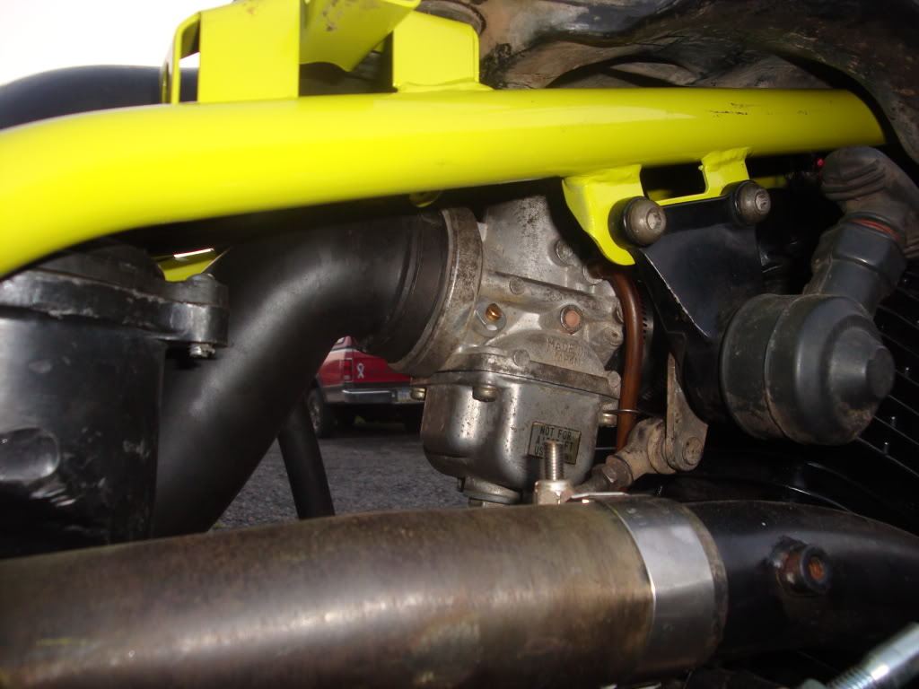

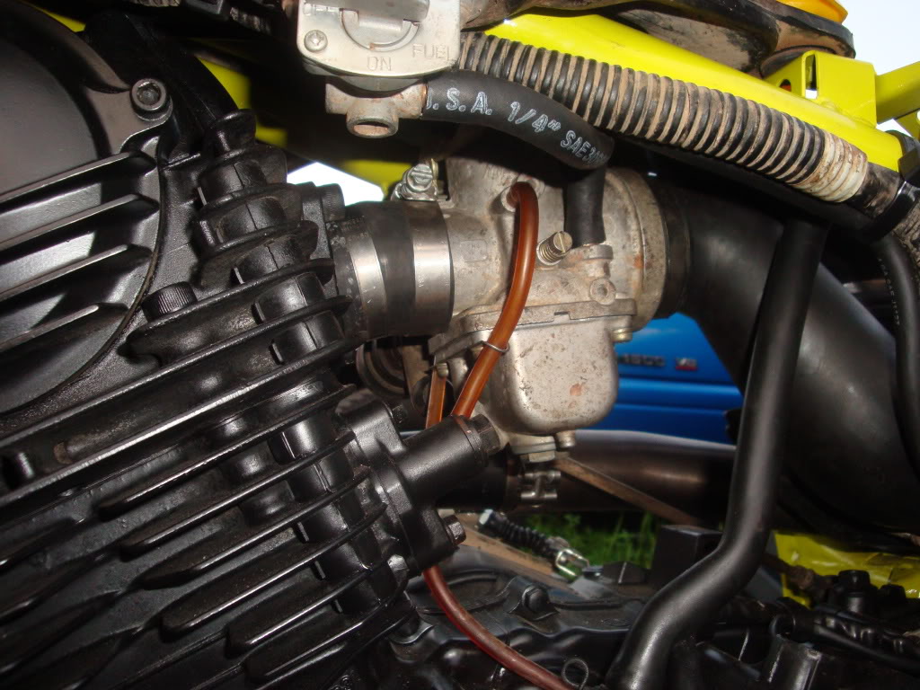

White Brothers Mikuni VM36 Carb Kit

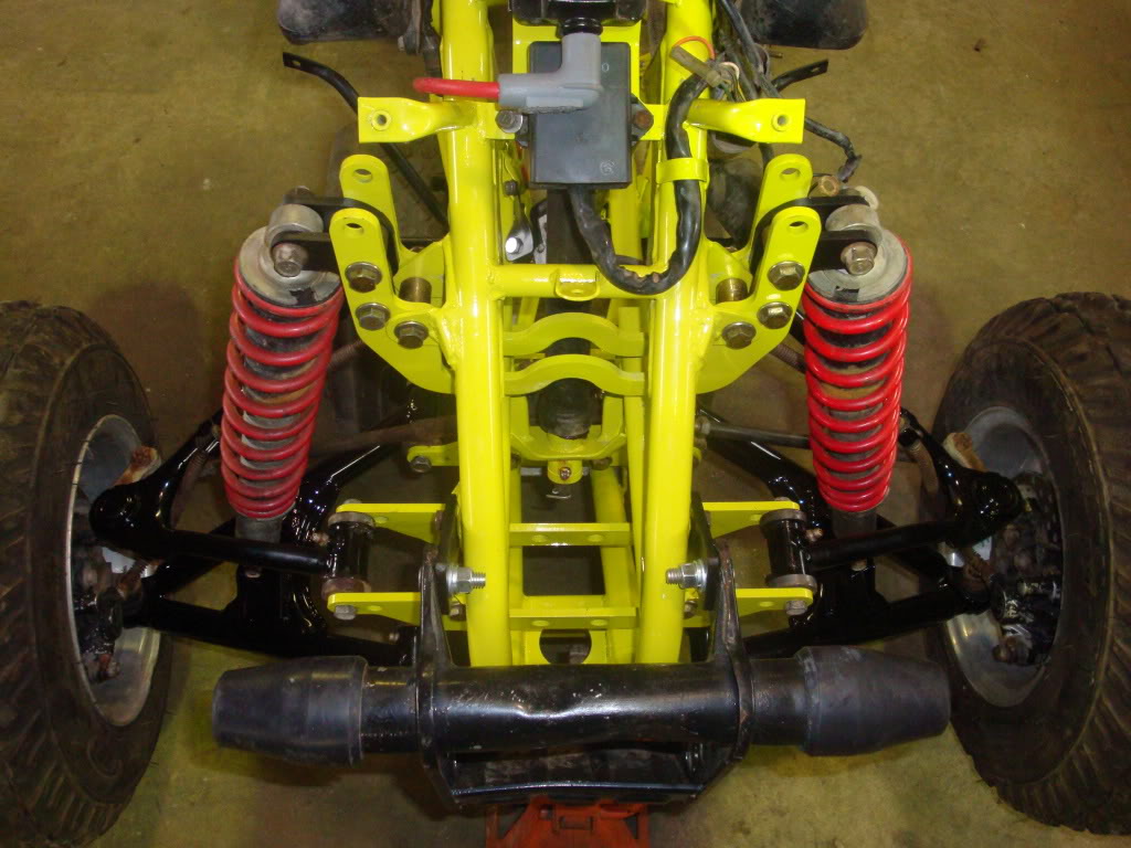

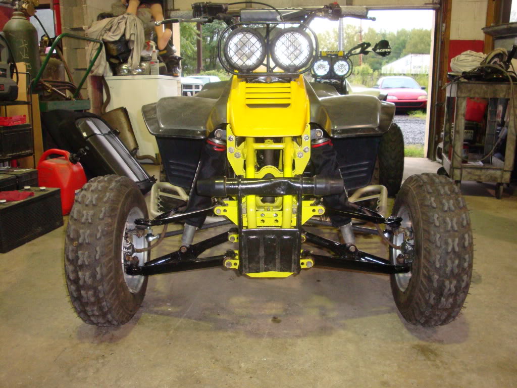

Diamond J Customs Front Widening and Shock Conversion Kit +6.0"
Honda 400EX Front Shocks
American Stars MX Star Chromoly Tie Rods +3

Interstate Battery
Custom Over-sized Battery Cables

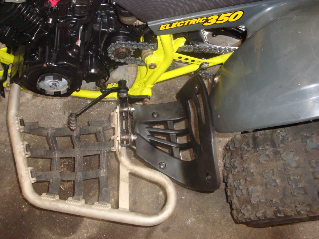

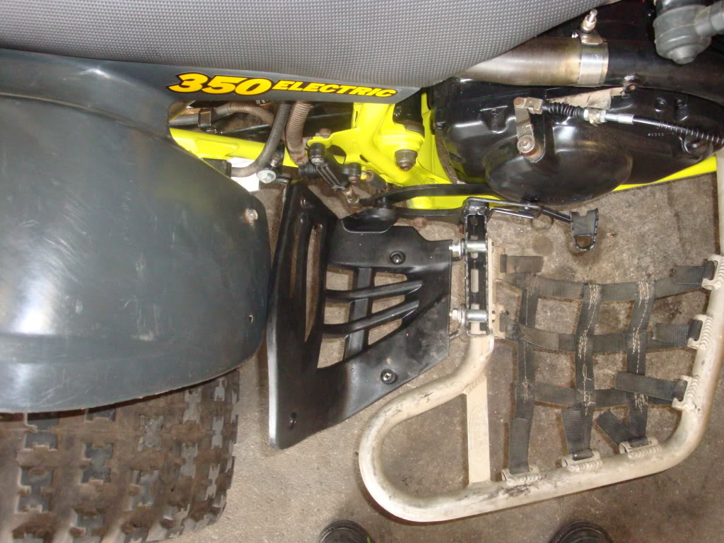

Looks good! Except I would ditch that carb and get one of a LTZ/KFX/DVX 400. Also the Raptor 350 Foot pegs are a nice upgrade, they are 2 and a half times the width of the stockers.

Thanks alot guys. I am hoping to have it running this week. As for the pegs I dont think I will really need to worry much as the bike is for my wife and she has small feet. :)

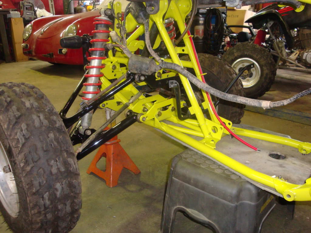

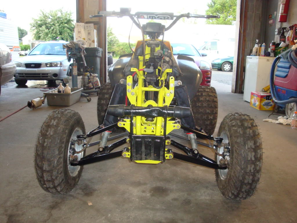

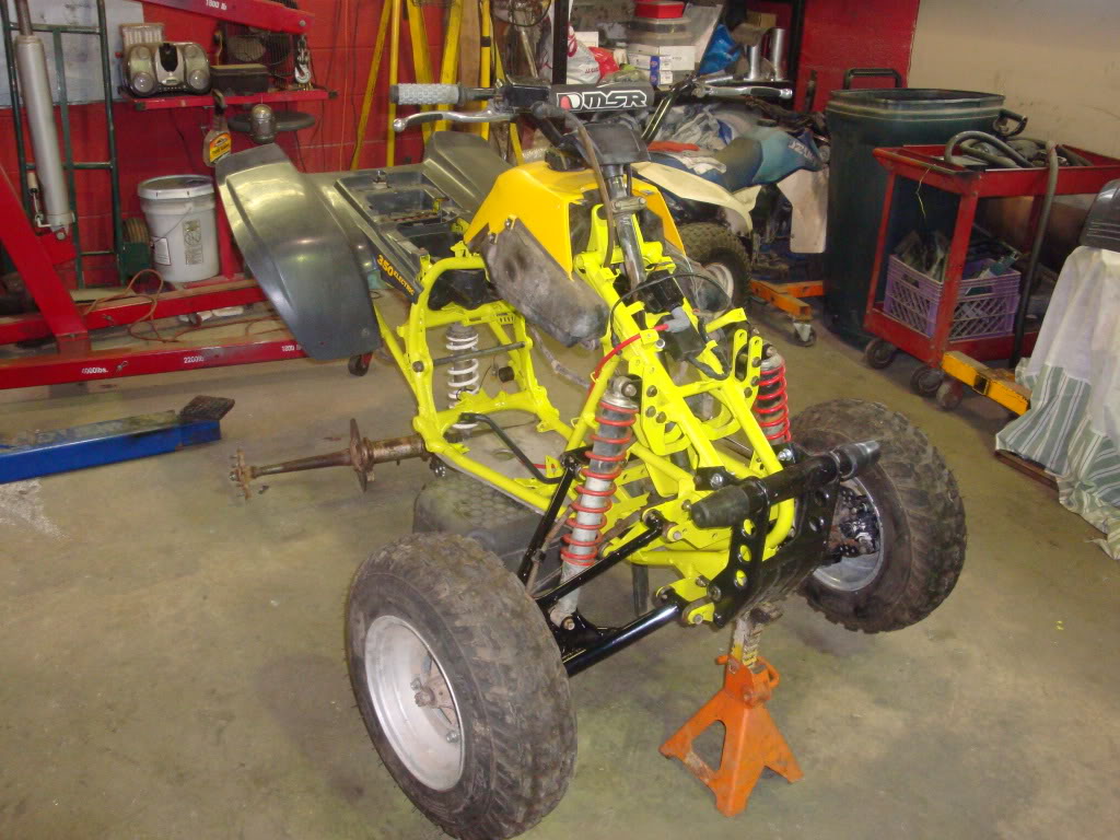

As for the carb, I will see how it runs and go from there. I was also thinking about running a Mukuni TM flat slide if the VM does not work so well. The front shocks are off a Honda 400ex and gives the bike alot more travel. If you are interested look into Diamond J Customs for a shock conversion kit. I am not sure if it will work with the stock width of your bike though, you may need to do a widening kit or longer A-arms.
As for that Porsche is actually a very old kit car (57 replica). It is built on a VW frame and does have alot of real parts on it. It is in need of a redo as well.
I think my friend is going to sell it.

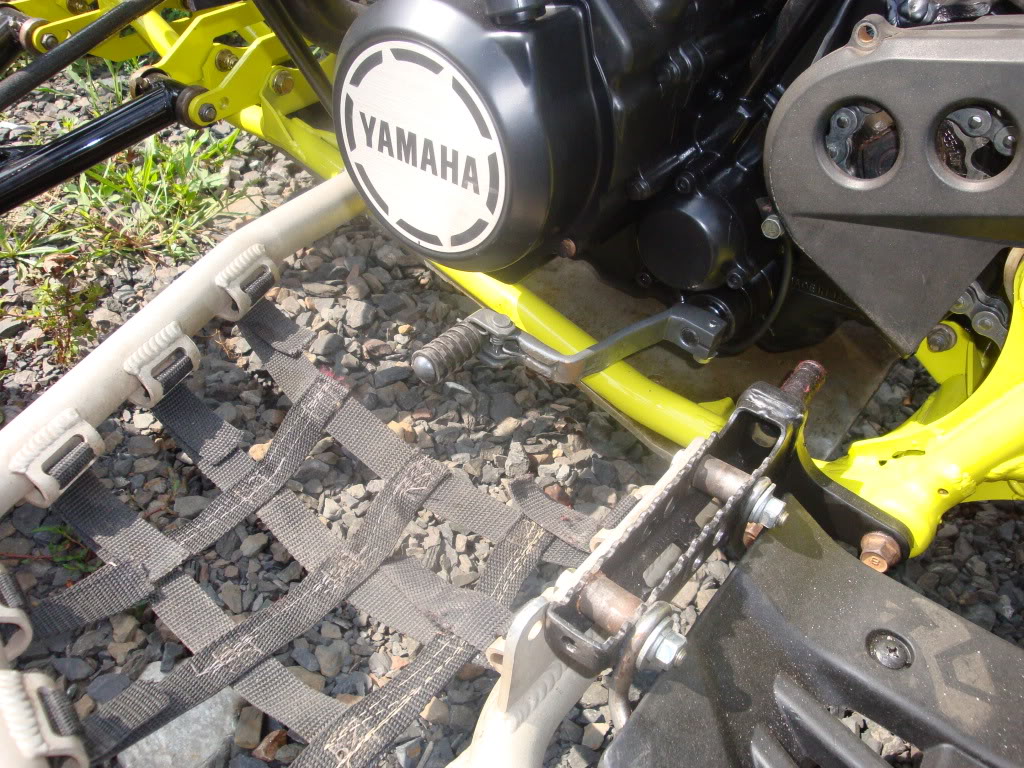

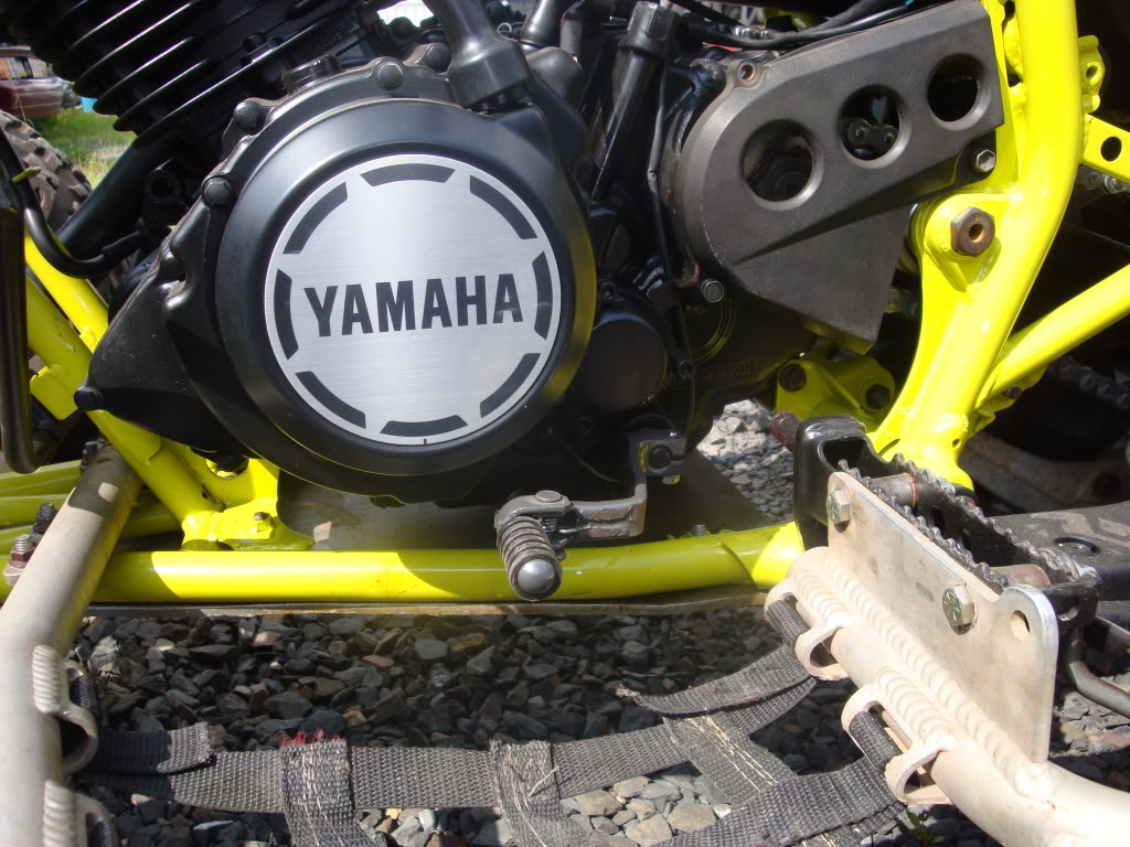

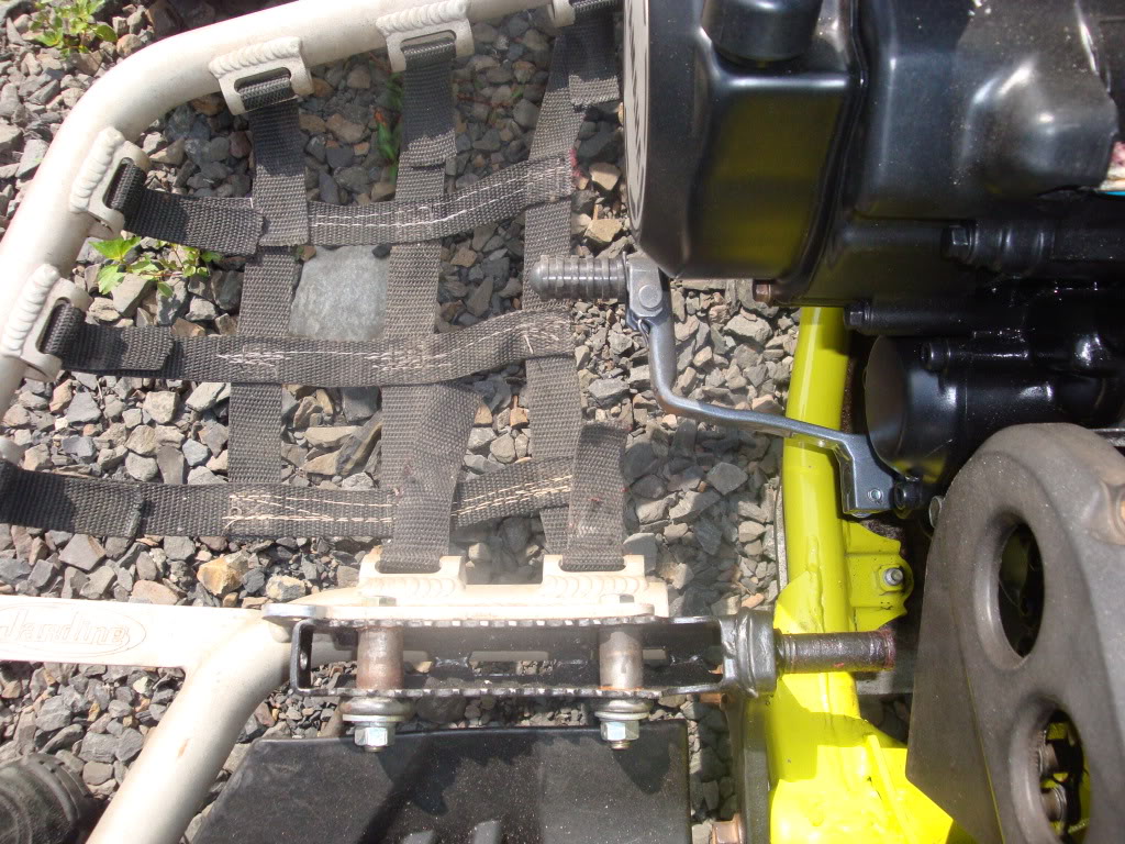

Shifter Pics - IMS Flightline YZ250
I had to rebend this shifter in my press to allow it to clear the recoil pull starter. Fits perfect now.

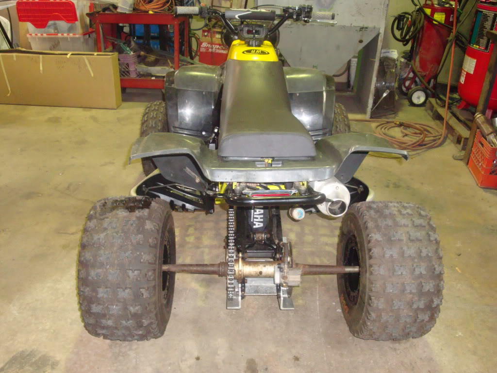

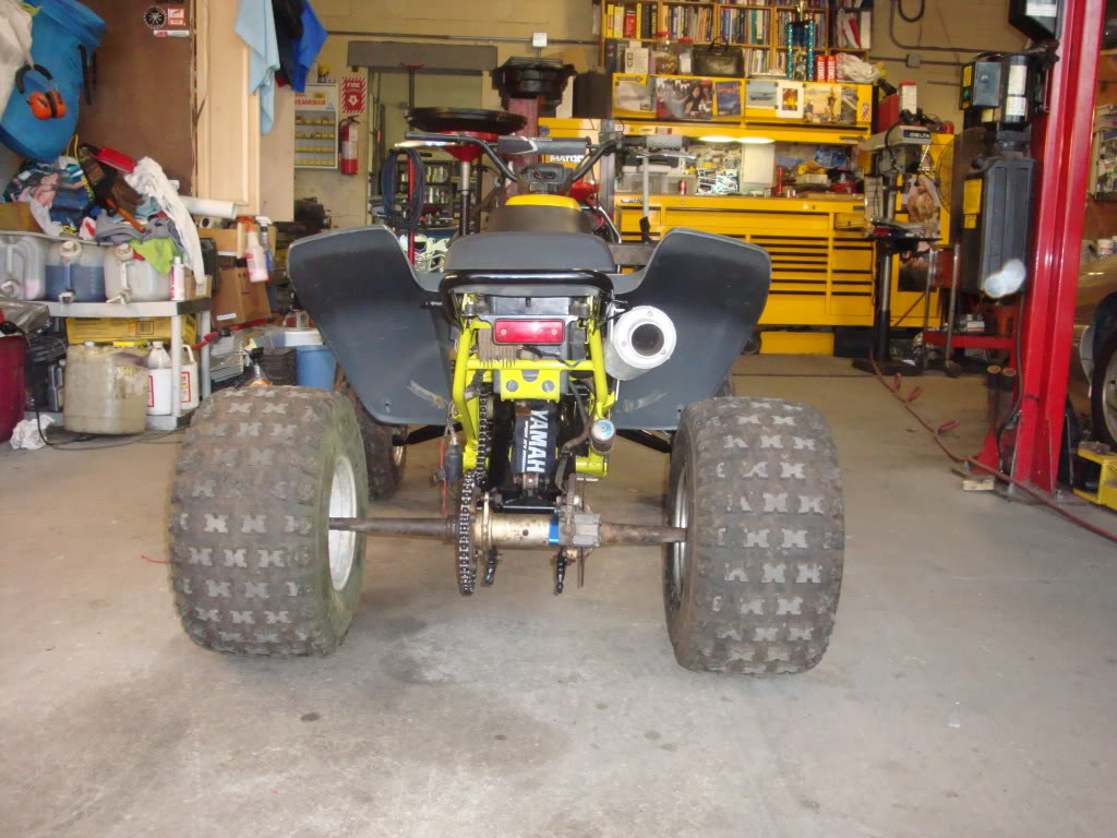

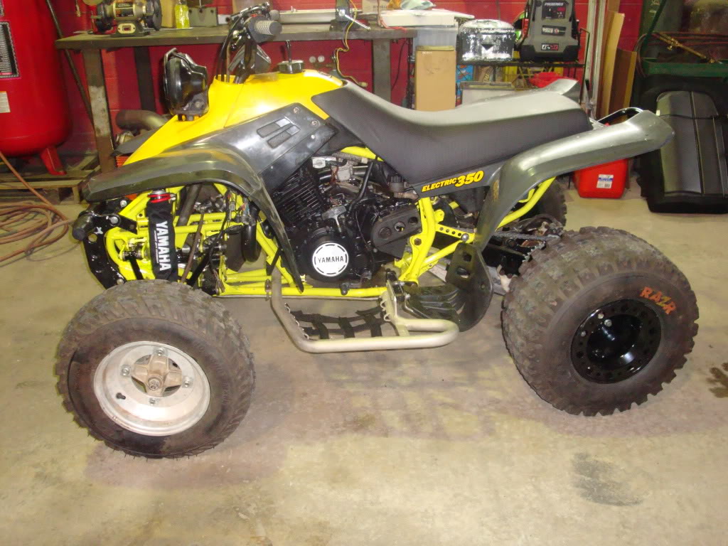

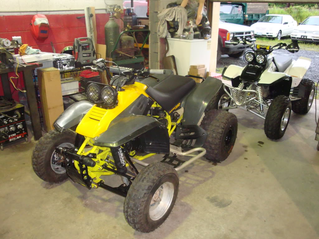

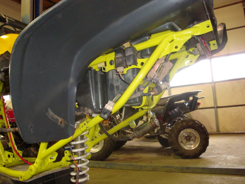

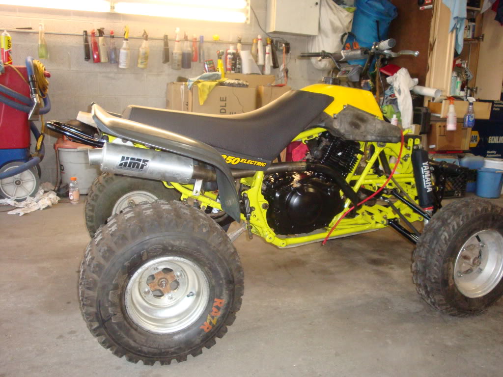

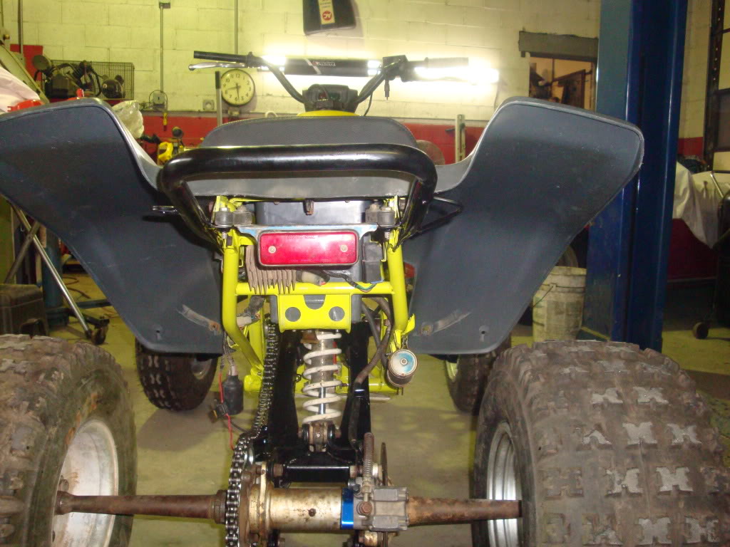

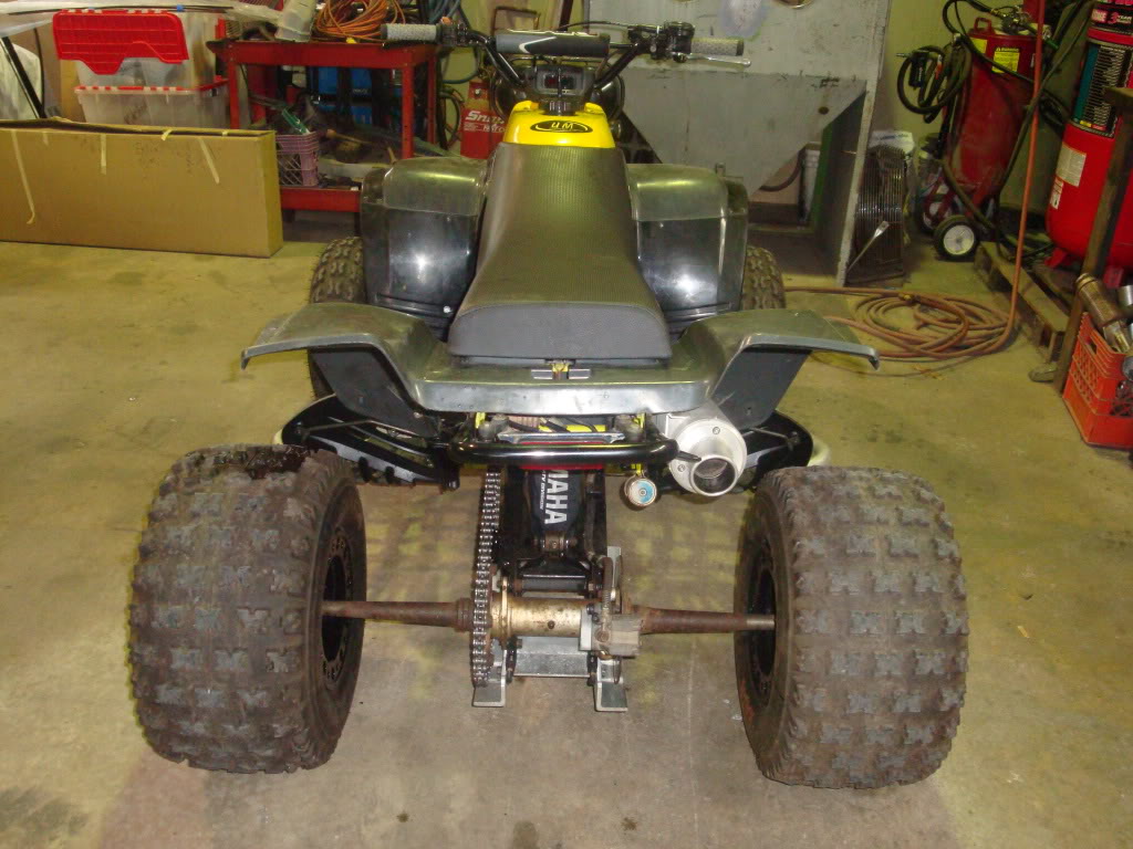

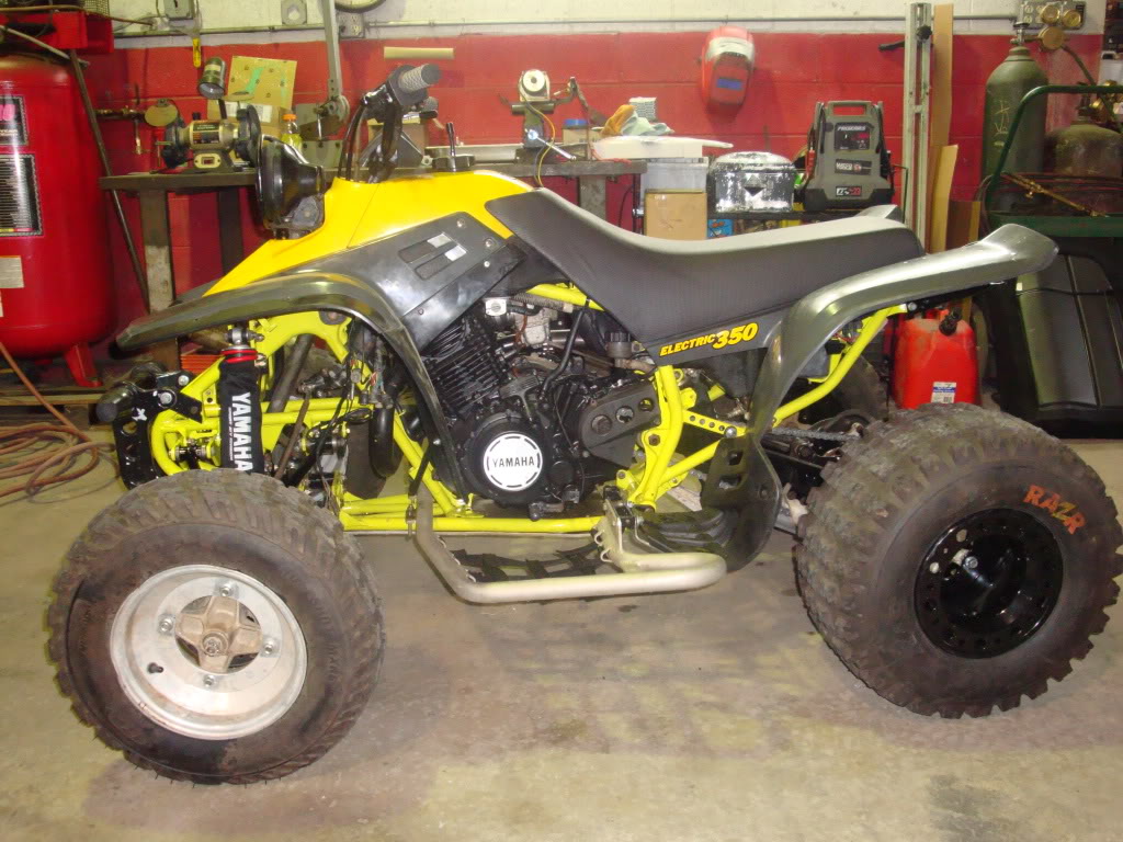

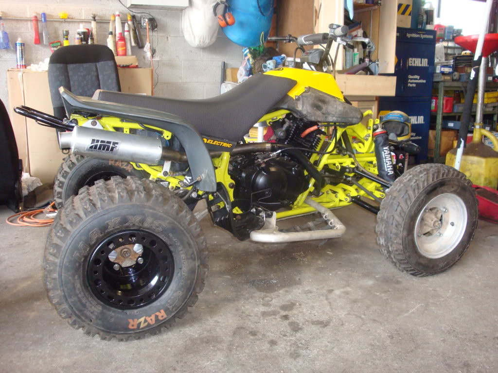

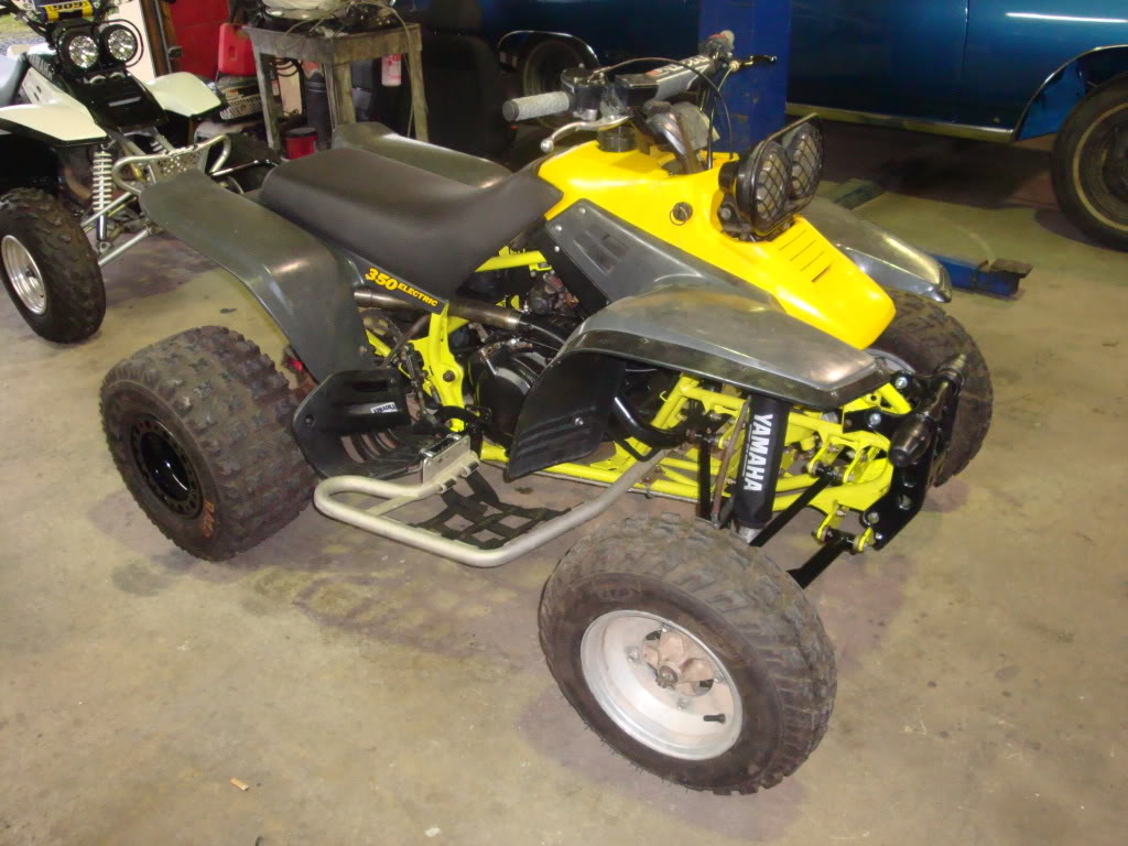

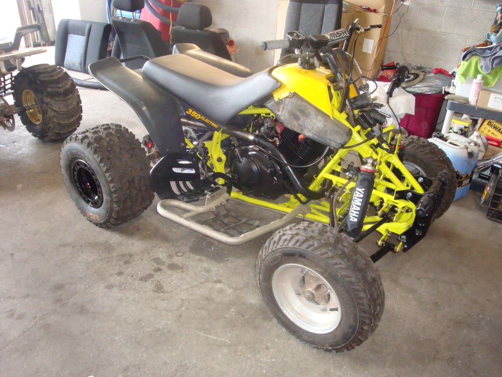

OK Finally some finished pics. It still does not run but at least it is a complete bike now. It looks as though my cdi box is bad so I am waiting for one to come. Then I hope I will finally be able to ride this thing. :)
time to widen the back now hehe =] are u painting front rims to match the rear just wondering looking sweet man raptor 350 plastics bolt right up too if u are interested in buying them

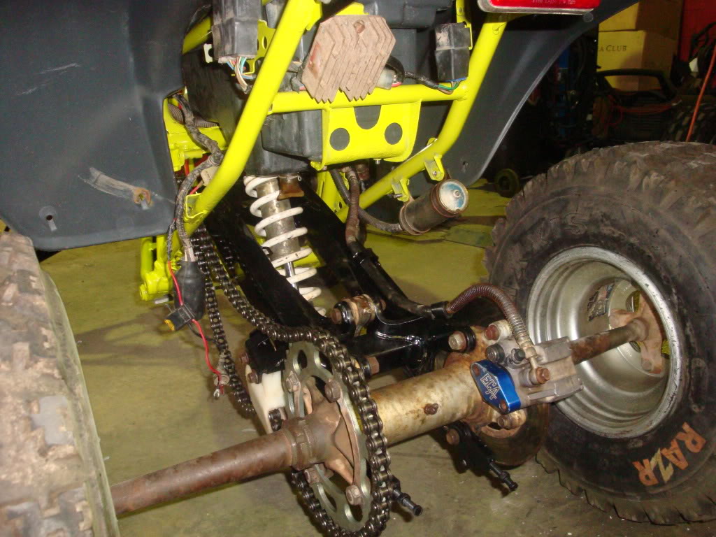

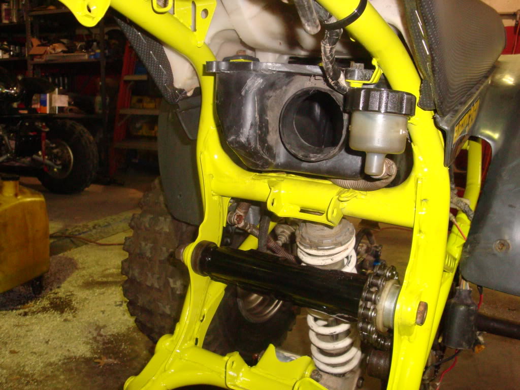

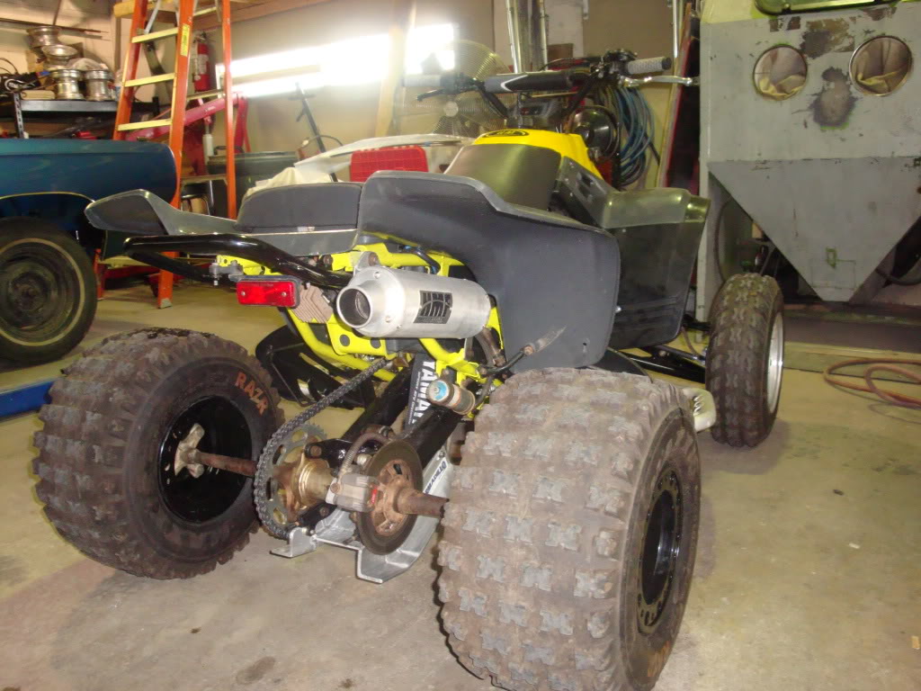

I will be replacing the rear axle & carrier as soon I have some more cash, Also I will replace the front wheels with matching ones. I wanted to make sure the bike ran good first before spending more money on it. I will probably get a Dura Blue Eliminator 2+2 rear axle. I will also probably get a billet double bearing carrier from RAD. I already put on the different offset wheels to help compensate for the wider front suspension. They are 6x3 offset, so that gives me another inch on each side. I also want to get a different front bumper and some steel braided front brake hoses, then I should be all done. AS for the Raptor plastics, I dont think they will bolt right up as the 87-89 frames are different than the 90-04 ones. I had to modify some stuff to make these fit. The headlight assembly is from a 90-04 and I had to weld the headlight bracket assembly to the frame. I got the bracket from a guy with a bent frame, He cut it off for me. Also the hood does not bolt on the same I still need to make a bracket for that. I will finish that up tomorrow morning.
