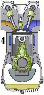

the fuel with the oil goes through the bottom end then moves up to the top end.
This is how a basic 4 stroke works
