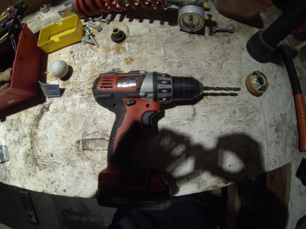

Anyways first you will need:

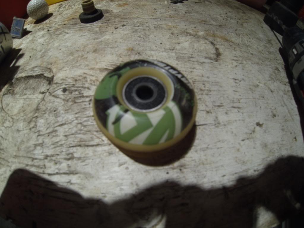

skateboard wheel:
bolt, 2 washers, a nut, a lock-nut: (yes it is straight the lenses on my gopro does tht)
drill bit/screw gun:
and a saw-zall/hacksaw (hacksaw for if you have swing-arm removed i don't think it will fit otherwise)

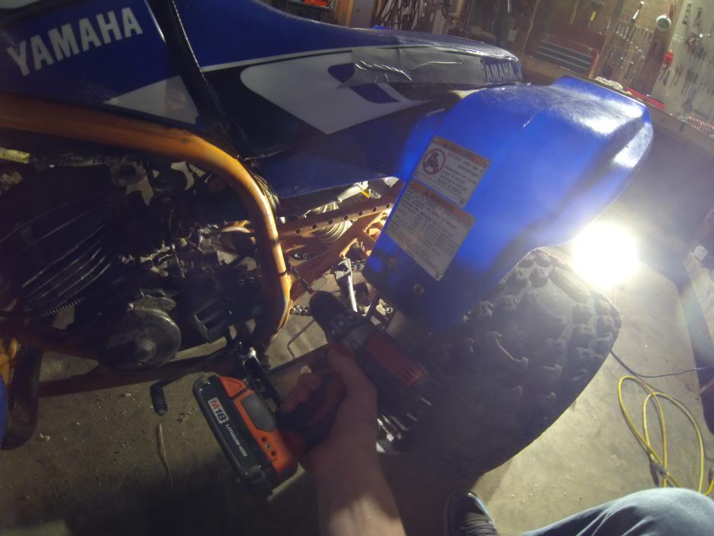

First: remove old roller (if any is left) cut the shaft for the roller off.
^^removed i forgot a before picture
Second: take your drill bit slightly larger than bolt.

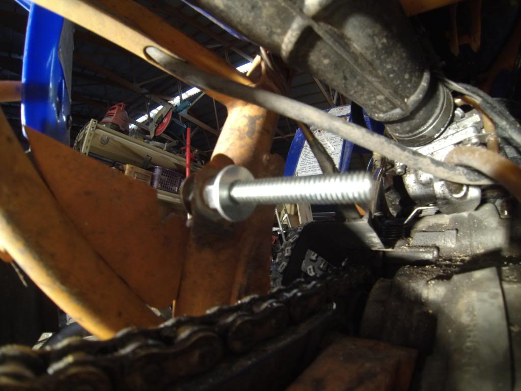

Third: slid bolt into hole, and tighten nut on the other side, slid a washer onto bolt then your wheel, washer, and lock-nut.
