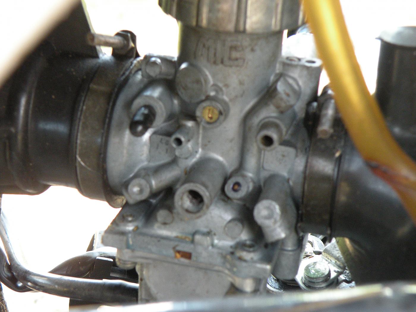

Is this the carb you guys are talking about? If not can you please identify it? sorry to res this thread.
http://www.planetcalypsoforum.com/gallery/files/4/3/7/8/6/dscn5793.jpg
sorry this is it>
he hasn't been on here in a couple years
Thx AWK !
Jimmer Hey buddy i did notice you ran that carb also. I am just looking for a starting point on the jetting with this carb. I live in florida so I am at sea level so i understand every location is different. Do you remember what jets and needle you used? i tried to send a message but it wont let me. Thanks
any help?? I' wondering if ayone completed this swap? I bought it and was unsure if the needle it come comes with works or what needle do I need? An I figured 260 main, 32.5 good to start out???
