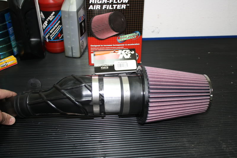

    I have not put a gauge on it to measure compression, but it was set up for pump fuel. I run the race mix to keep it cool as we work it pretty hard in the dunes. For what it is worth, the head had some taken off it for sure and has a much better shape to the dome. And it takes some more to kick it for sure. Feels good! And the filter is this..................

    First...get rid of the k&n before you need a new crank. you really dont have that much motor and a 28mm carb. the stock airbox and boot is capable of flowing a great deal more air. OMHO, go back to a stock type airbox or a 250r one, either without lid and ,move up to a 34mm carb. then invest in an EGT and use it for setup.
