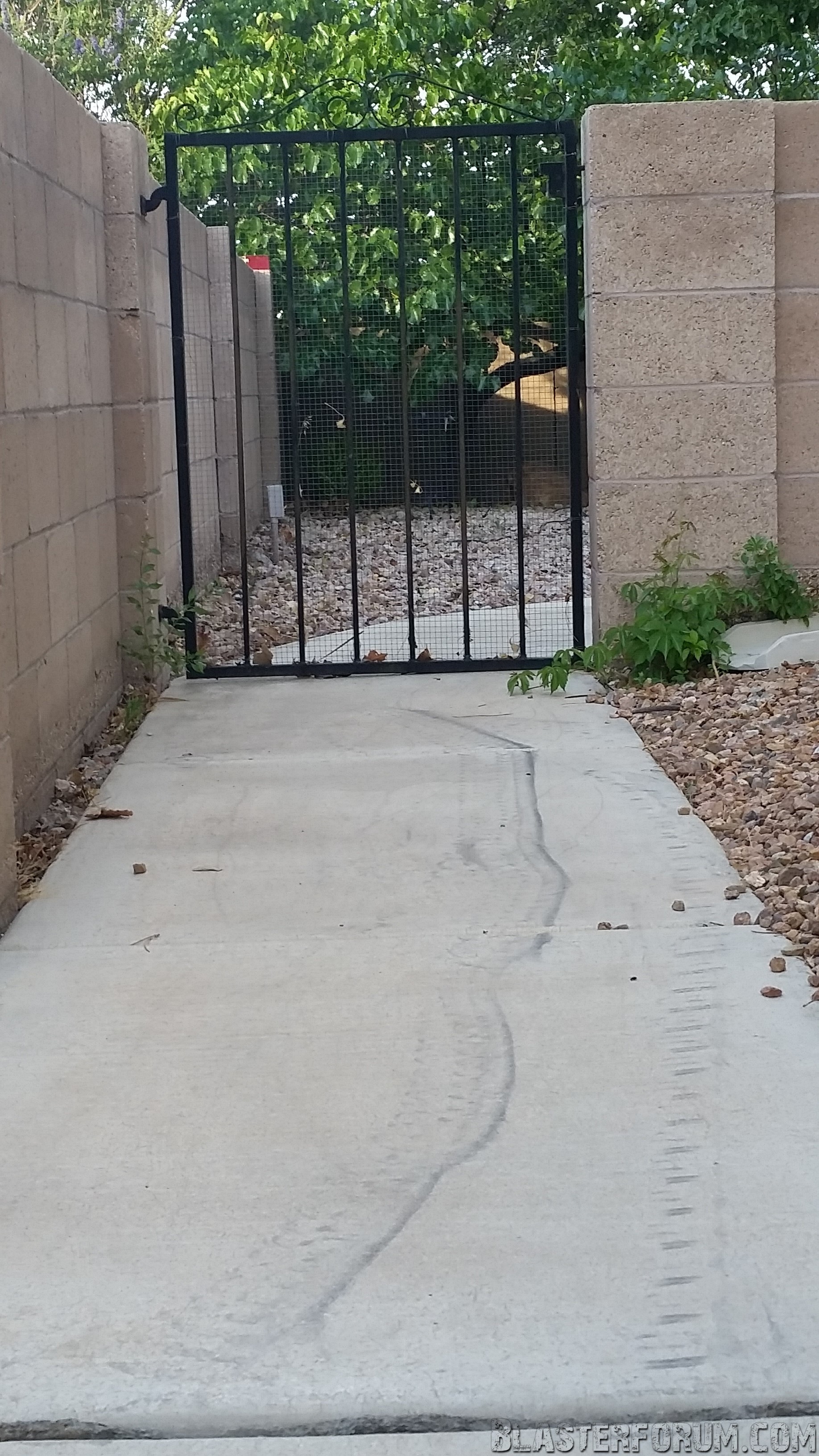

Hahaha that's awesome! I've never had that kinda transport problem before. But my new house currently only has a 35in wide gate into the back yard and the Blaster is 40in wide. First I tried tipping it sideways and wall riding through, but it turns out the Blaster has the width and height of a square. So yea, had to take the wheels on one side off.

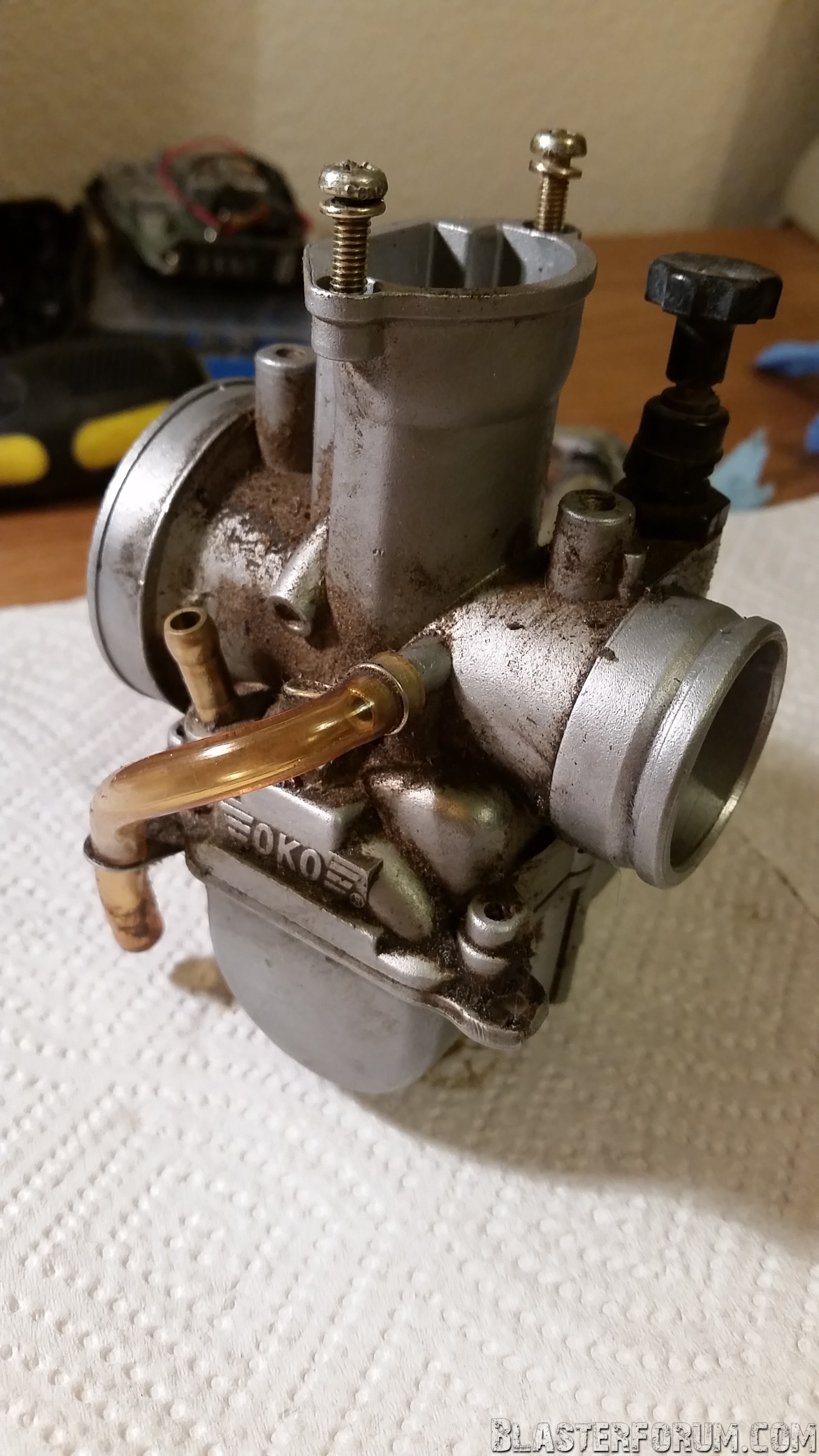

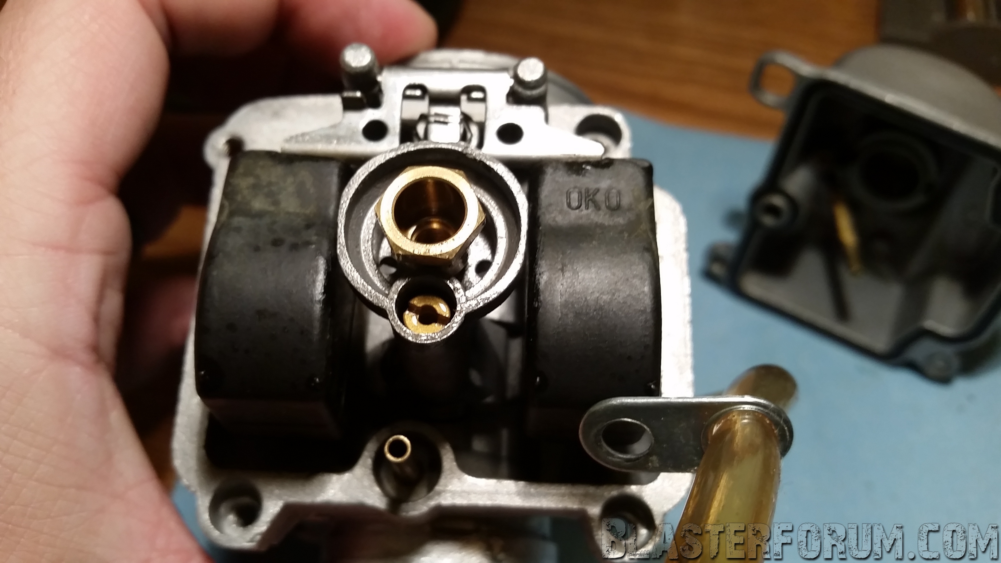

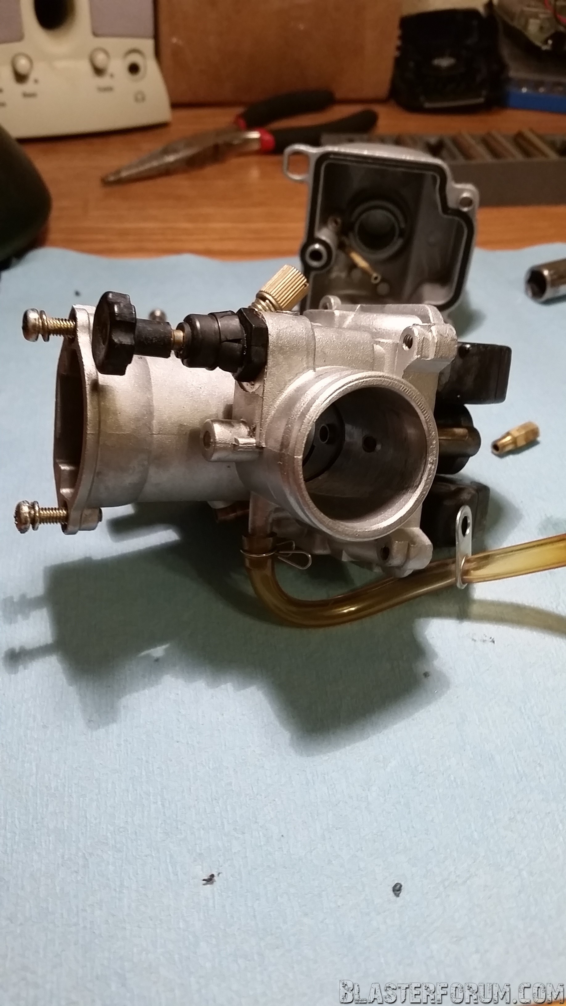

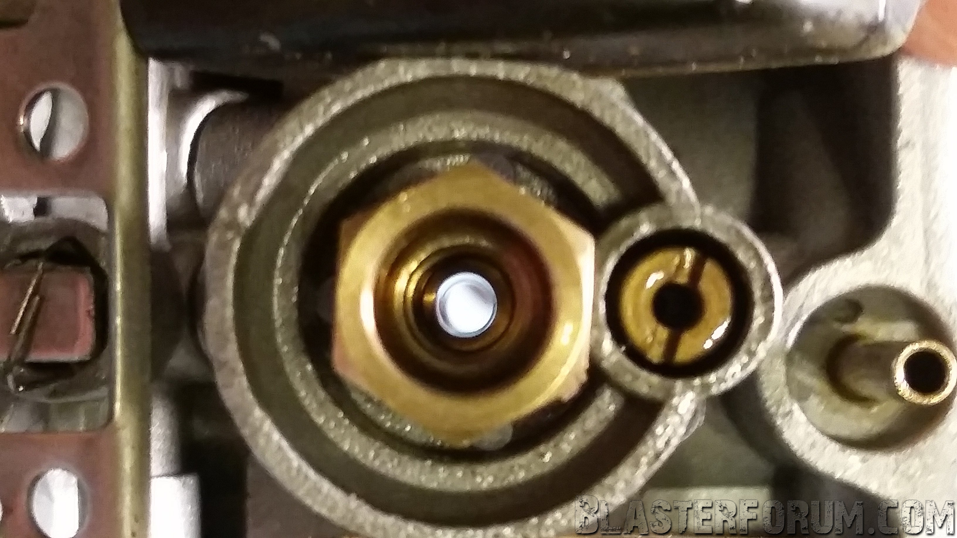

Alright, so continuing the mild teardown after half a decade, I was expecting to have to clean out some sludge or some kind of solidified deposits since I didn't use a fuel stabilizer. Don't know how well that stuff would work over long periods of time with pre-mixed fuel anyway.
Pulled the carb, had to clean off the outside to keep it from dropping into the insides;
full
full
Surprisingly, everything was pretty clean on the inside. No blockages, the float still moved freely, and there were no deposits to have to clean up so it was an easy carb refresh.

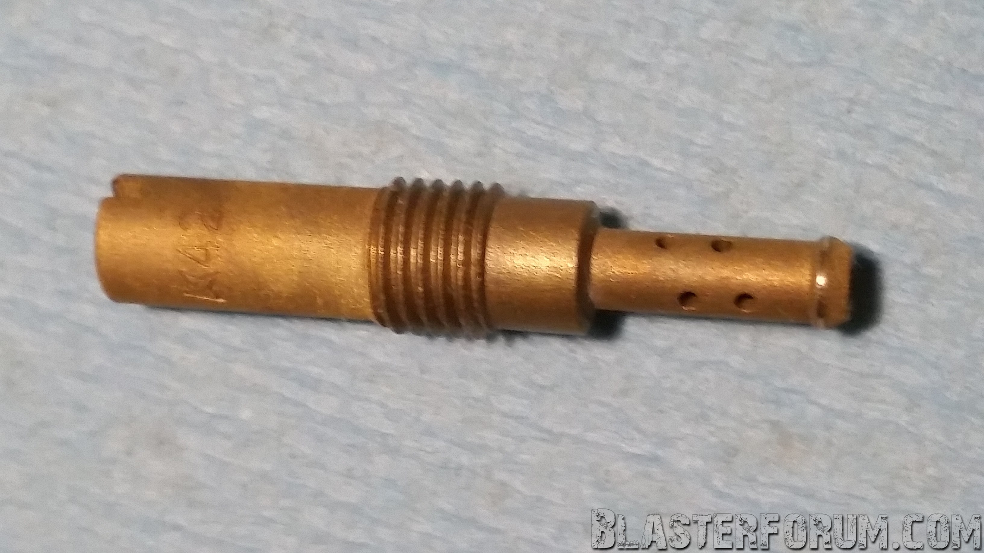

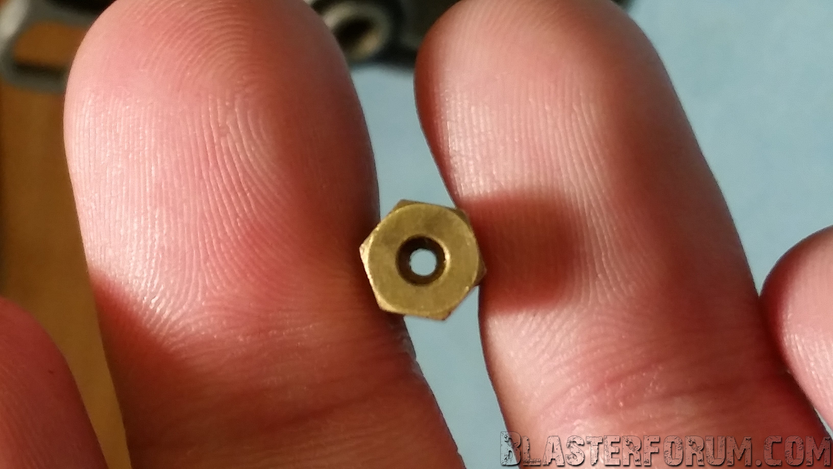

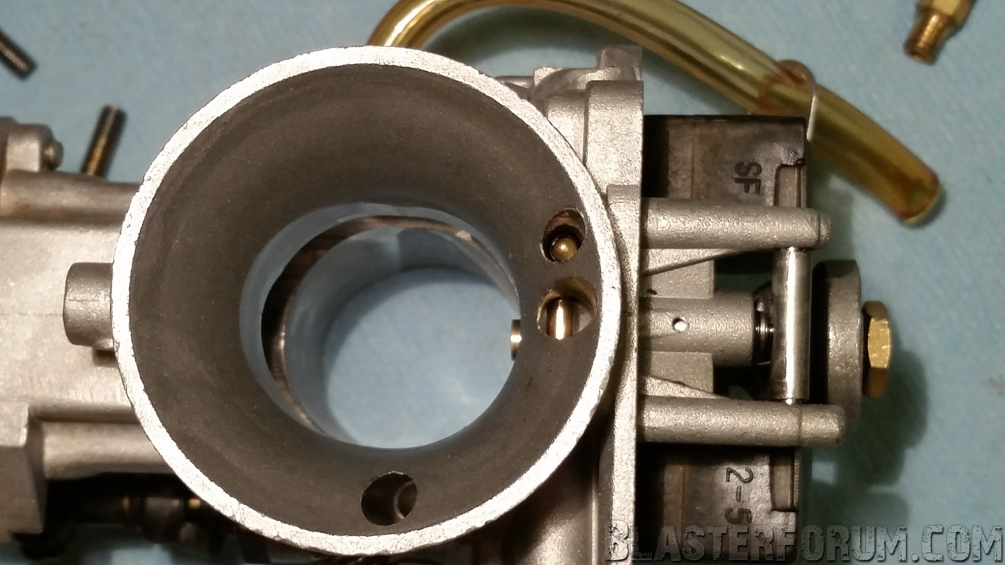

Pilot Jet looks good
full

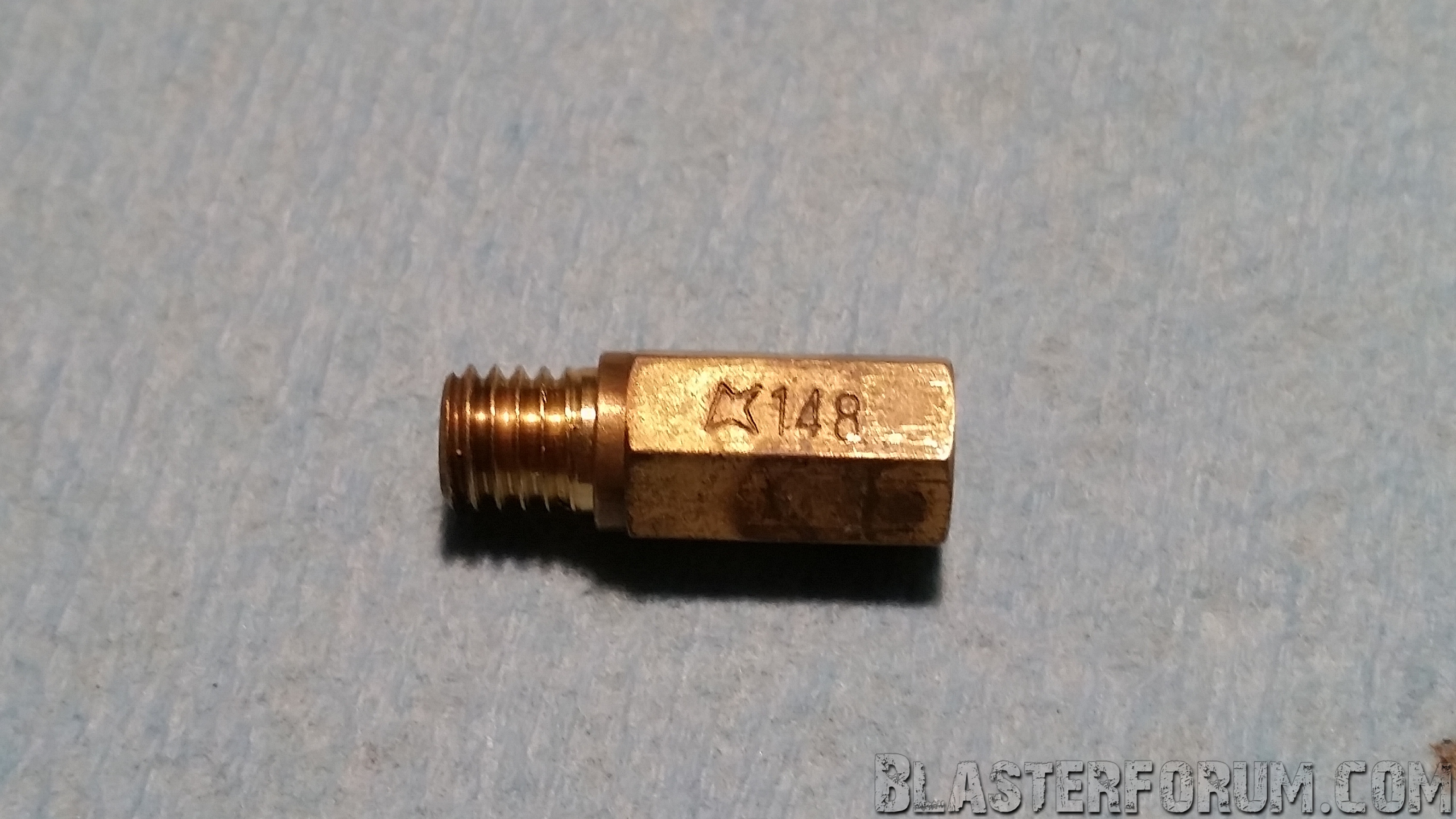

Main jet looks good, too.
full
full
No debris anywhere! I was very surprised.

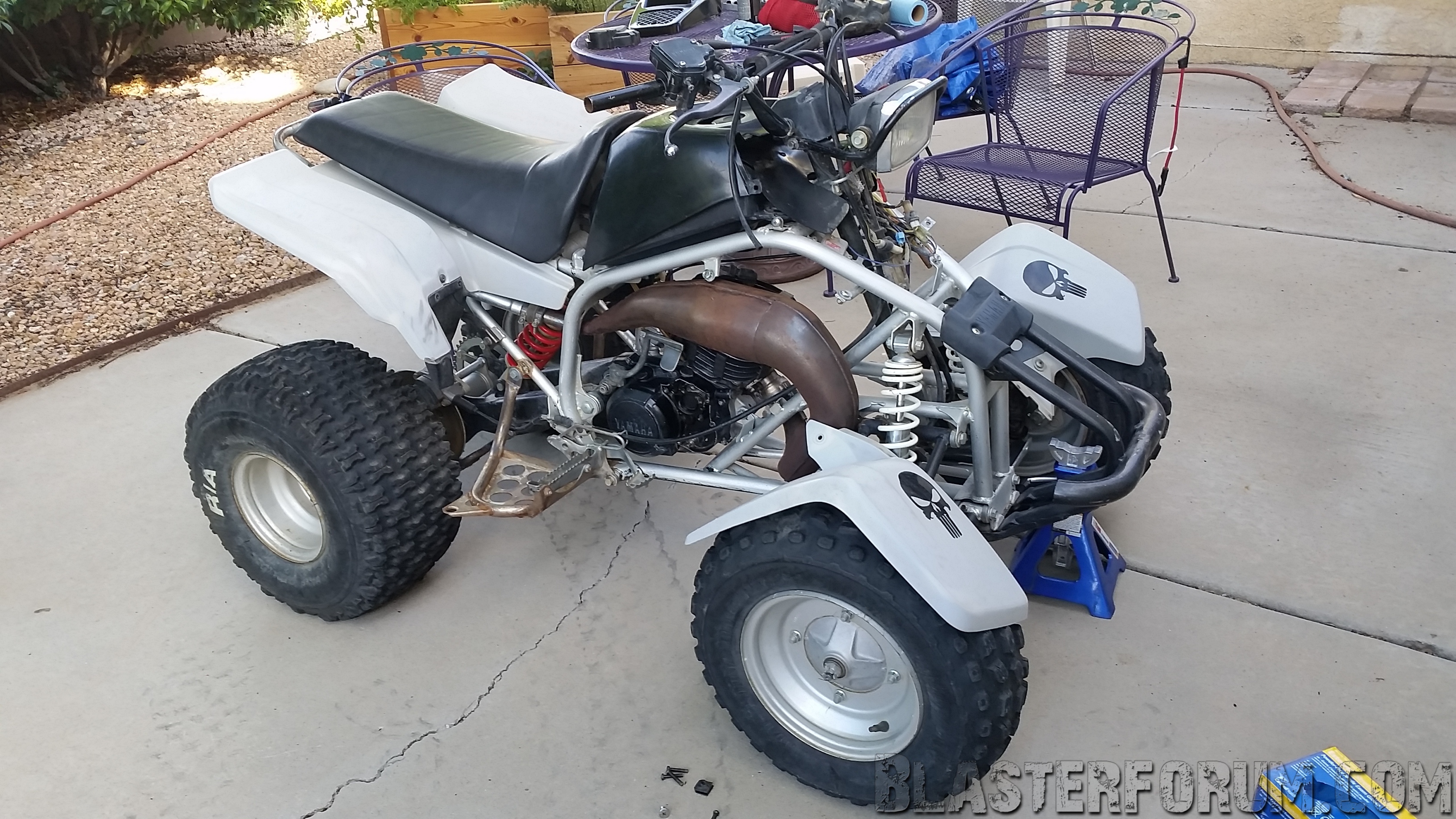

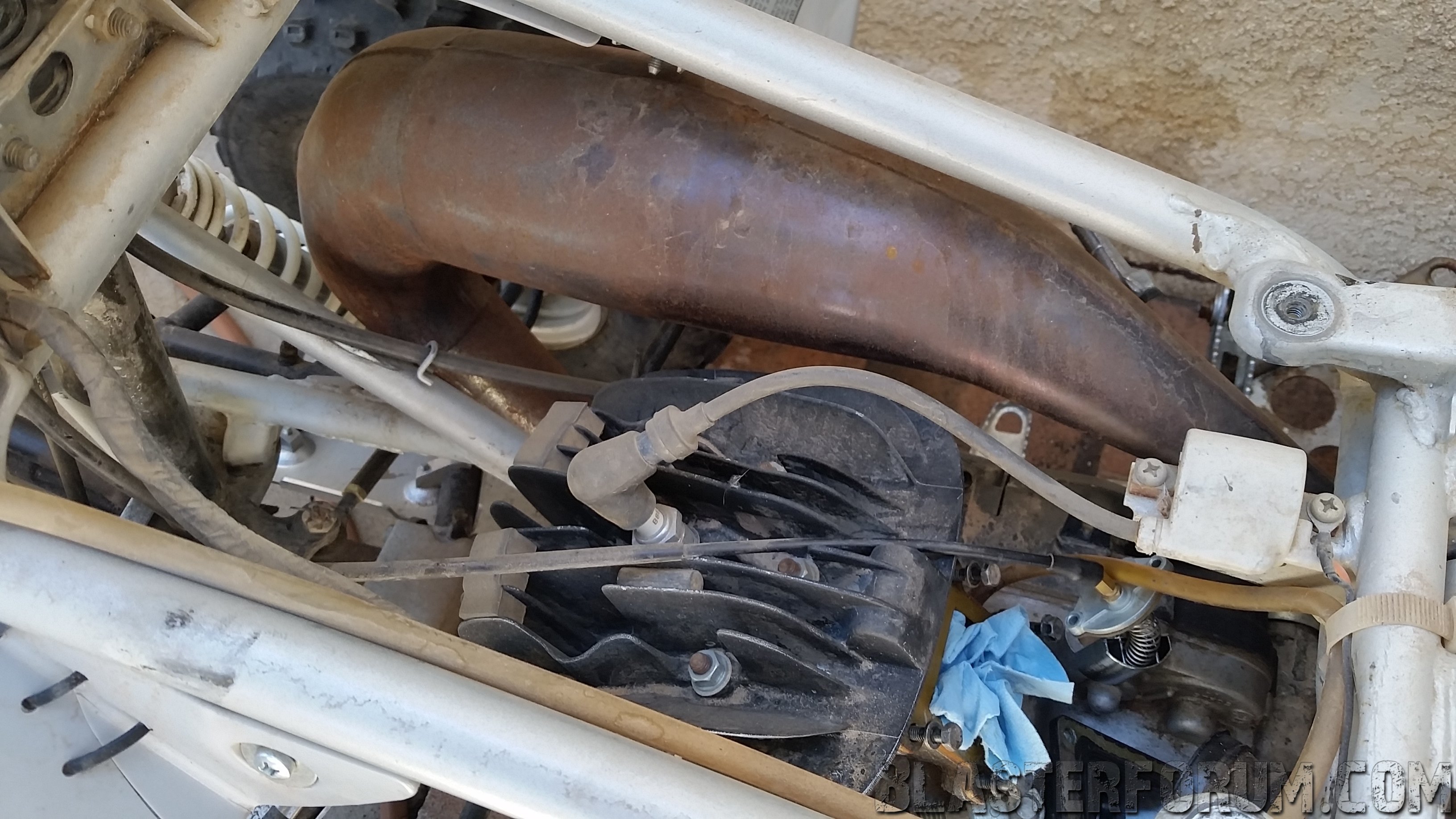

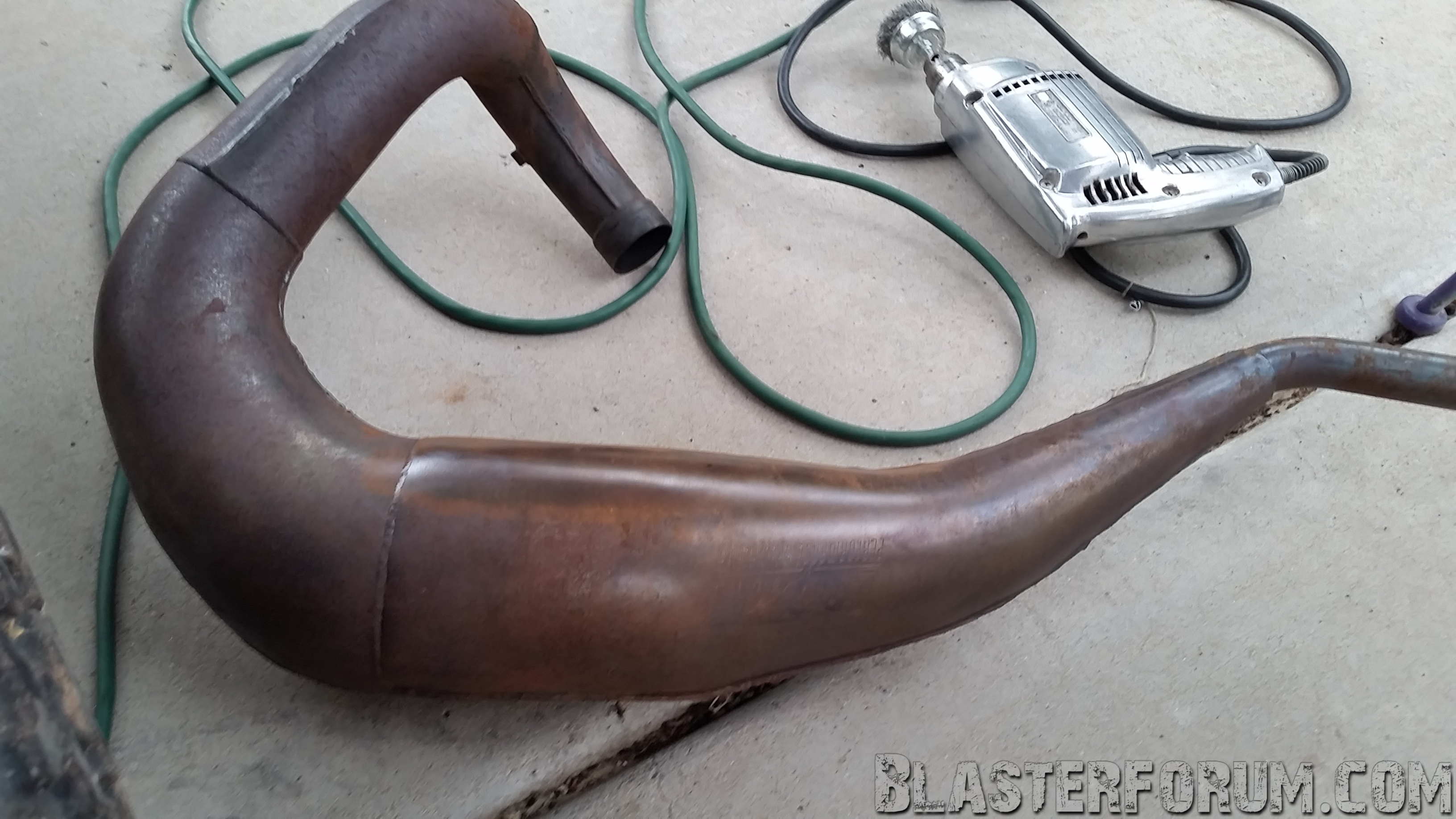

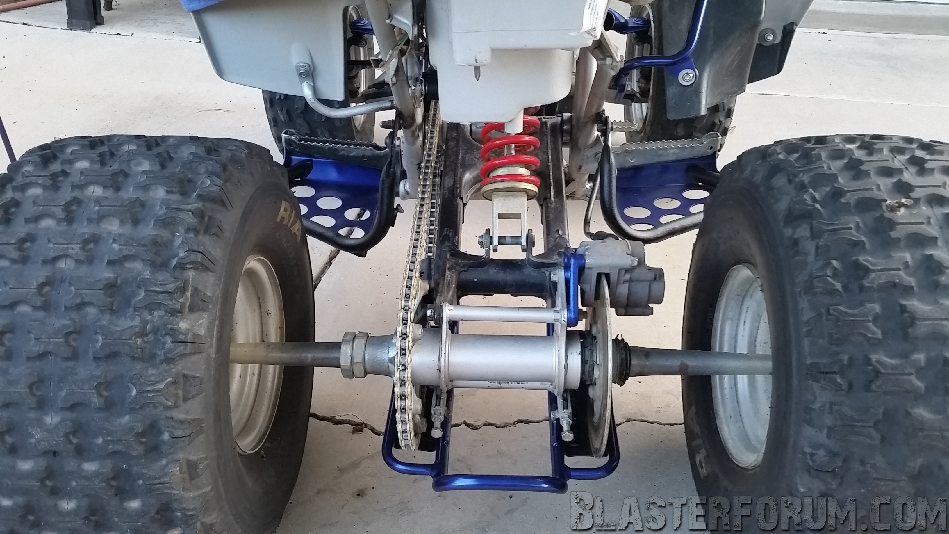

So..continued with my mild teardown. Well not so much of a teardown, more of just taking things off to clean and make shinier.
full
This is the result of maybe 2.5 rides. Good ol' desert dust.
full

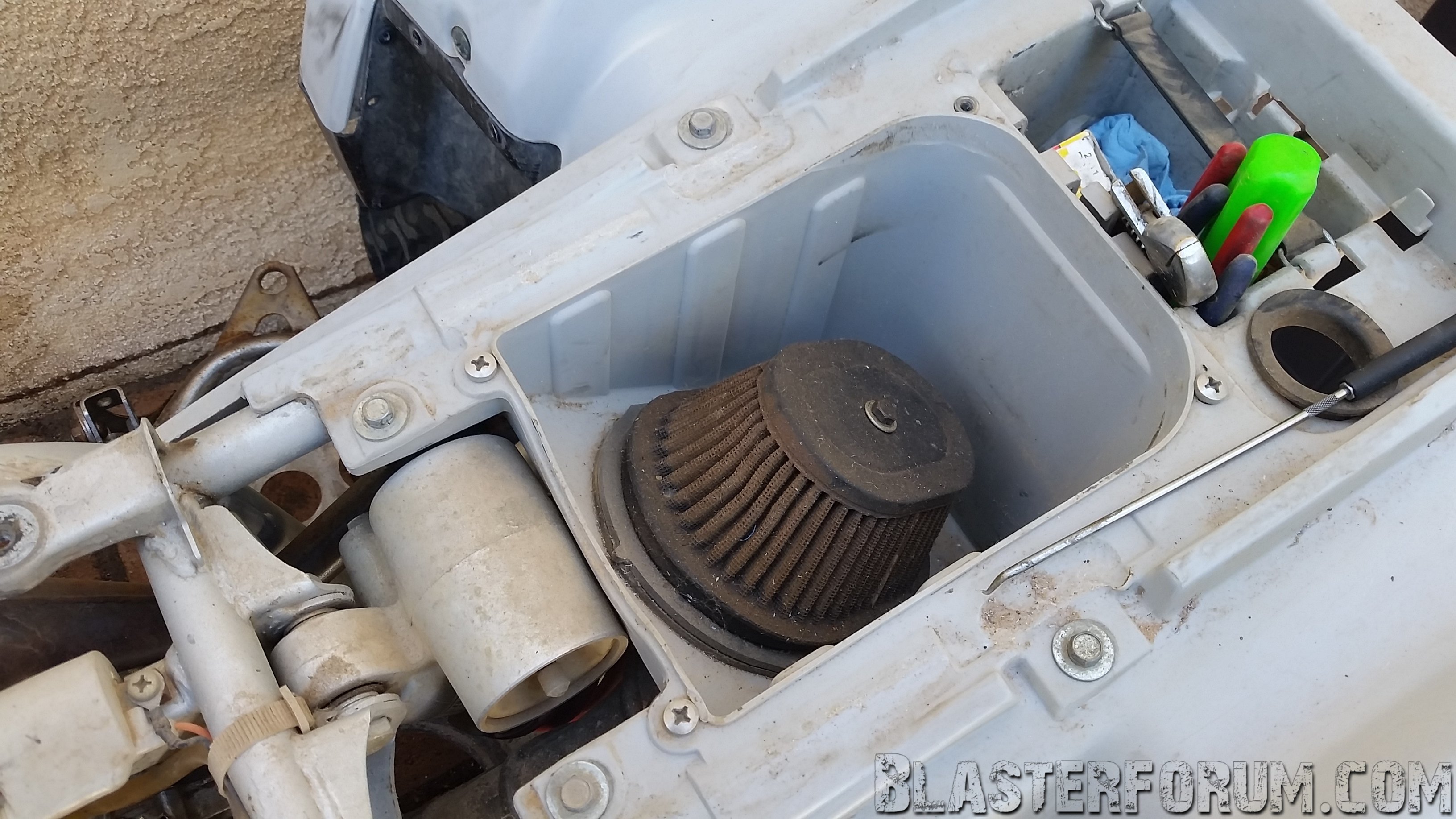

This used to look nice, too.
full

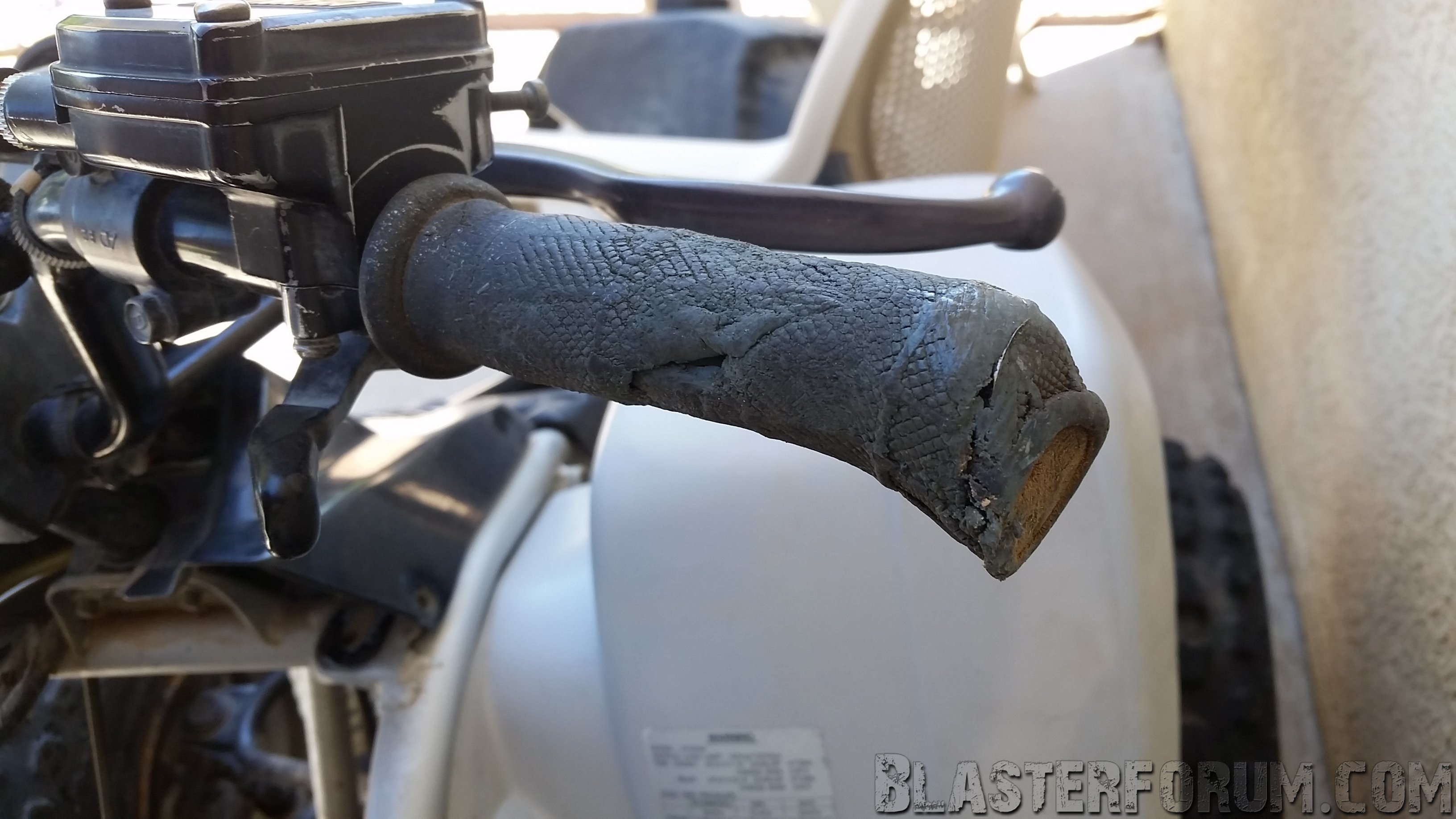

First thing I did was take this off to start working on it.
full
I guess these just melt sometimes?
full

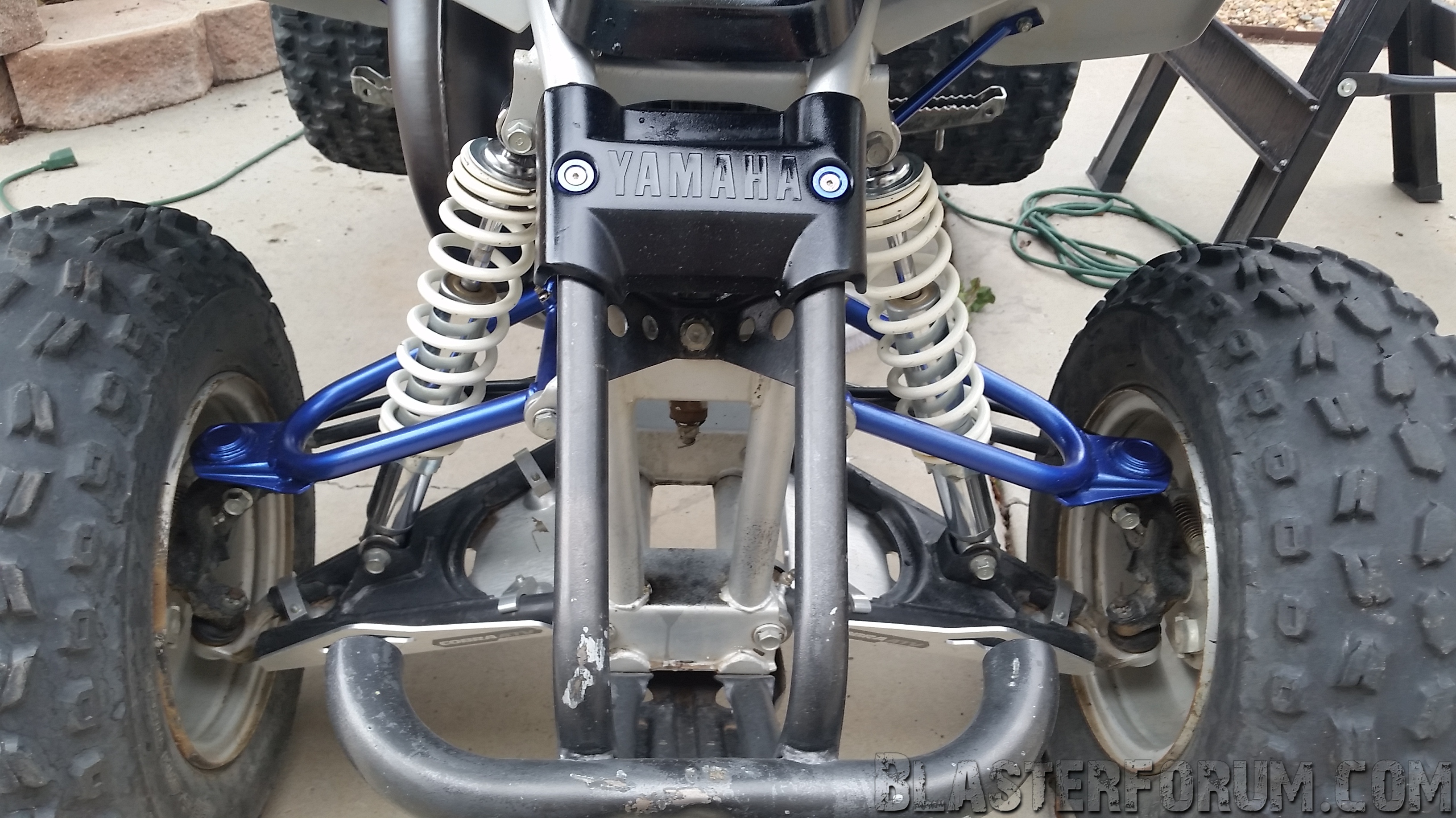

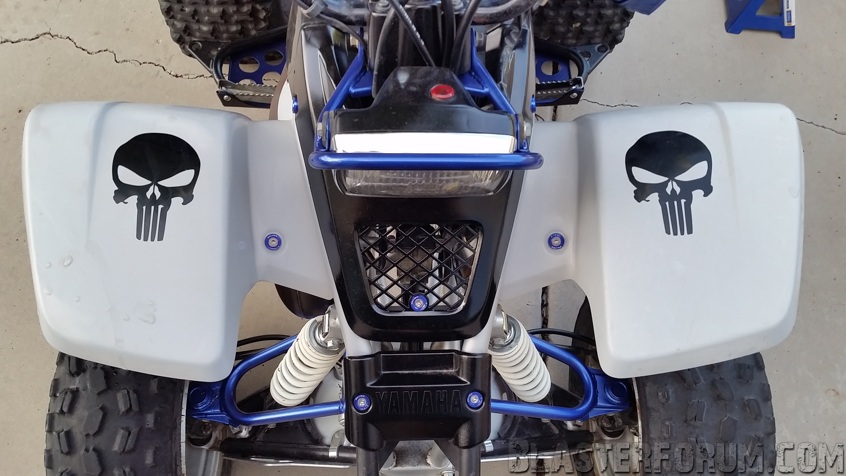

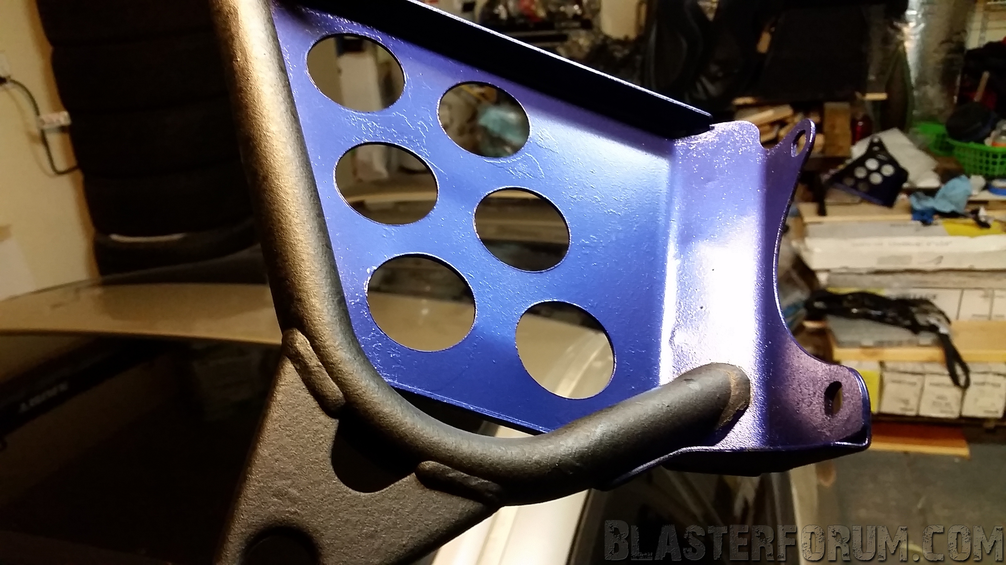

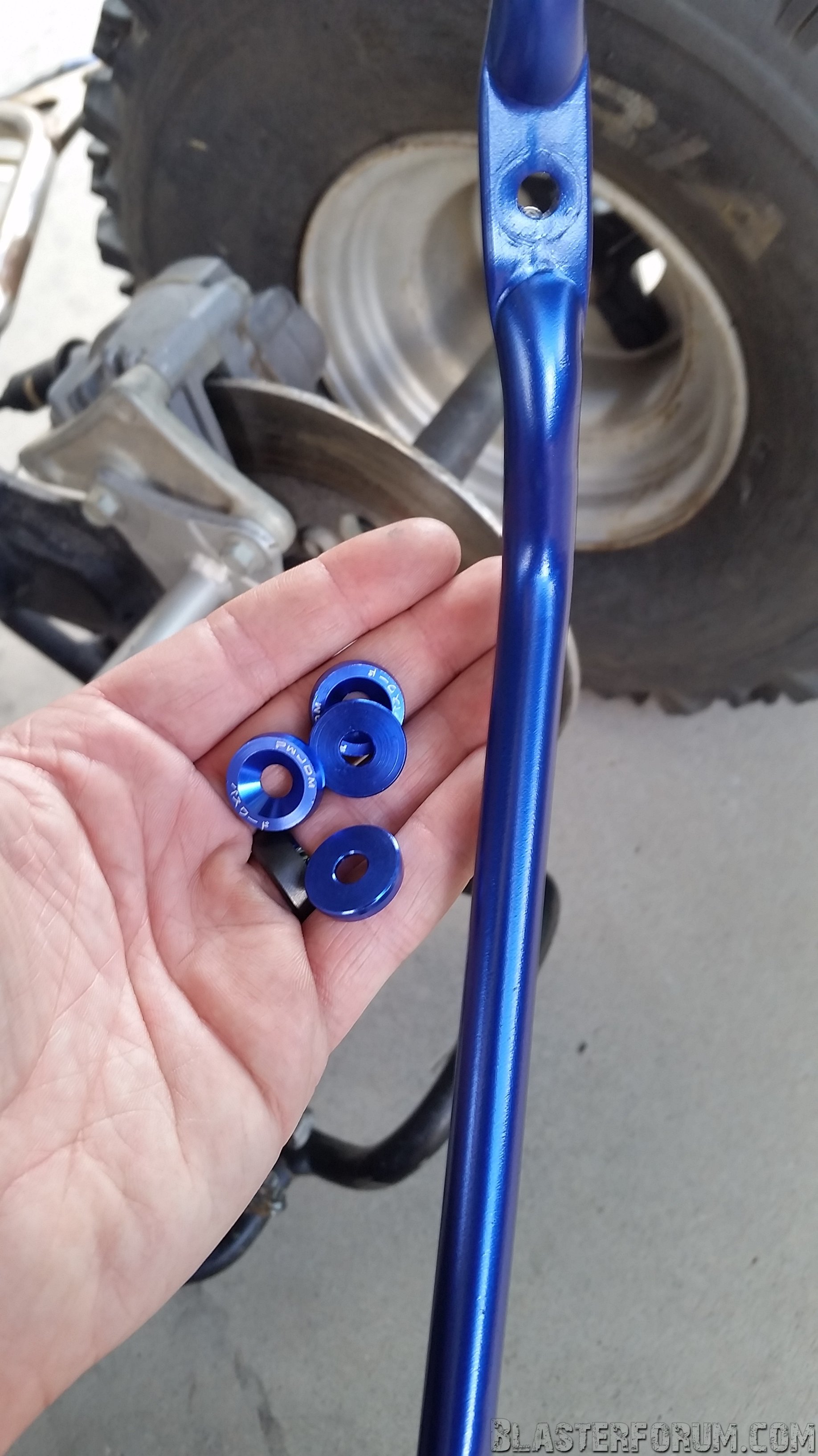

My best friend found a website to buy anodized dress-up washers for his car on the cheap compared to retail, and he hooked me up with a couple bags of blue ones so I thought I'd try making a color scheme out with them.
full
I picked right the first time, turned out to be a perfect match. Another very similar color is the Honda Electron Blue Pearl
full

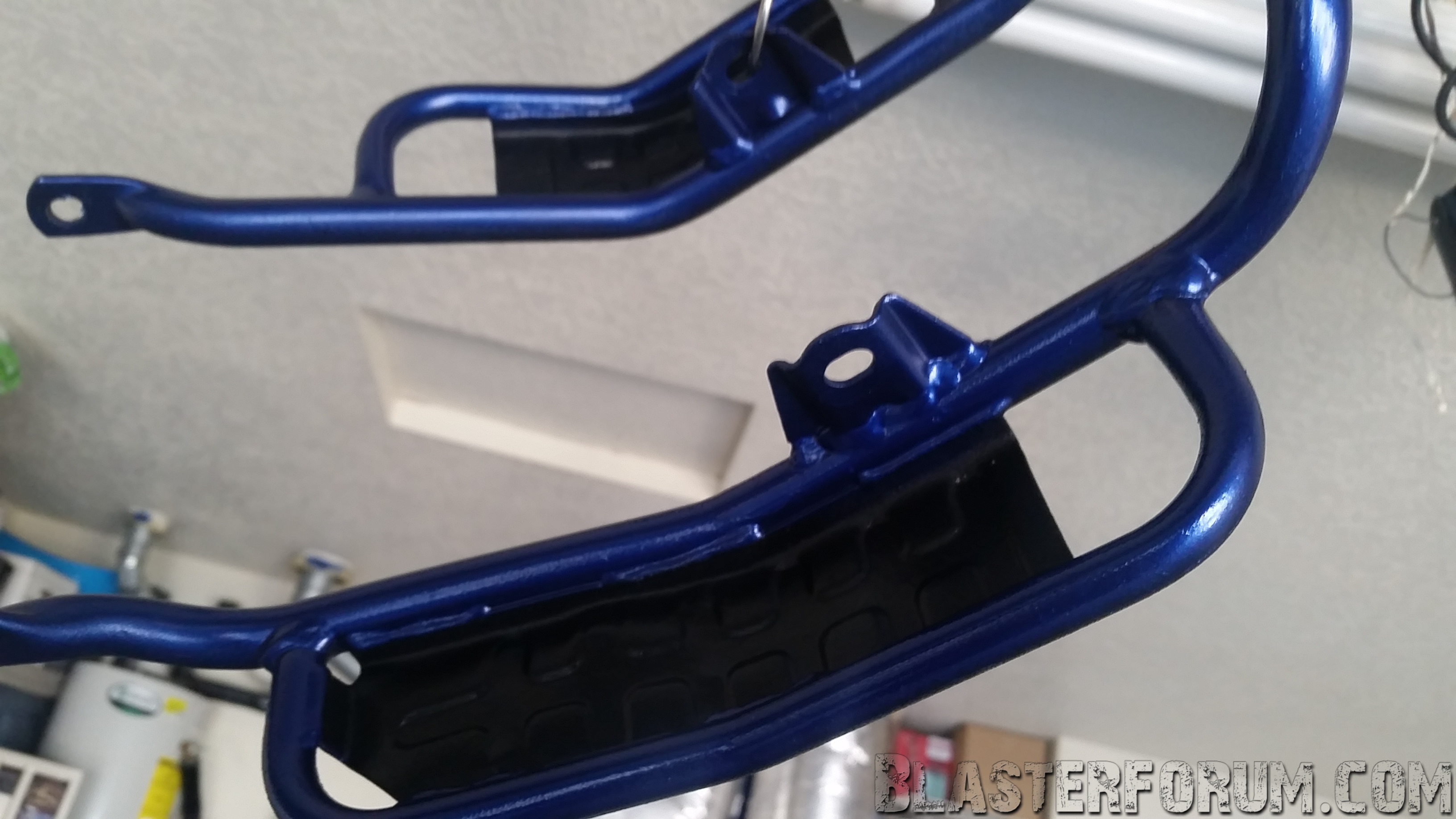

From there, along with the blue, I started hitting random parts with rubberized under-chassis coating and clear coat.
full
full
full
full
full
