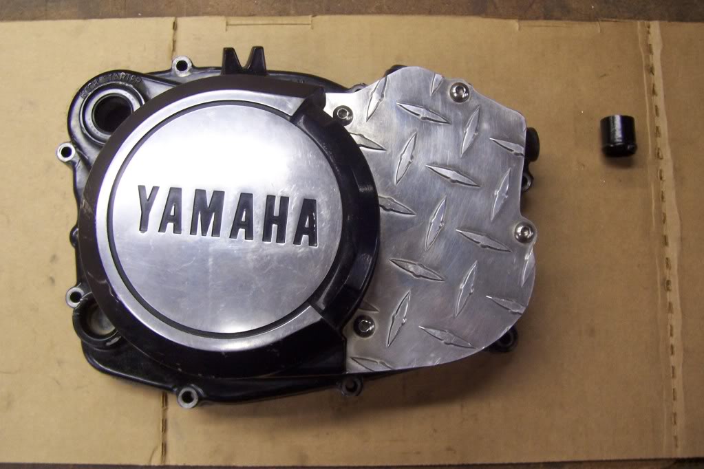

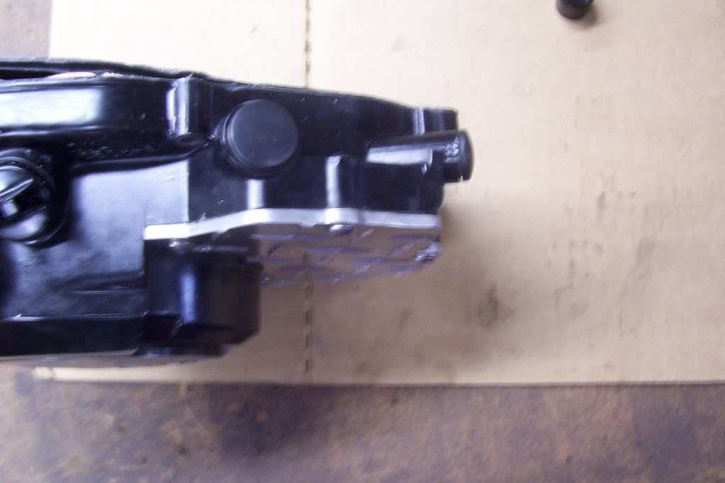

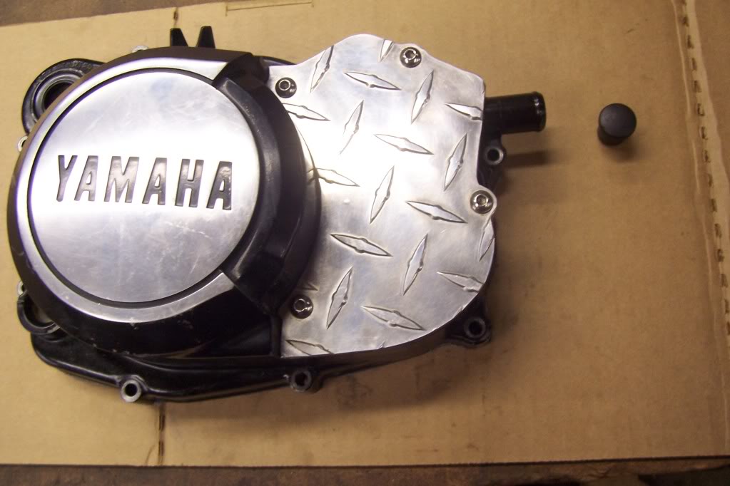

Do you see the tube coming out of the front of the clutch cover??? You dont need it on a air cold motor so just CUT IT OFF and put the plug back in... I think it looks way better!!!!!!!!!I:I

yep, i did this last year, makes getting at that front base nut sooo much easier
Well. I am certainly proud of myself that I determined that it was from the liquid cooled DT200 crankcase. Being that I am 14 years of age...
yeah, if you want the cover without it, it's the 06 for sure. that's what year mine is and it doesn't have it. i think 05 doesn't either.
AHA so thats why my friends 05 looks different than my 02 thought it was that for a while but I thought I was seeing things lol good catch and solution
