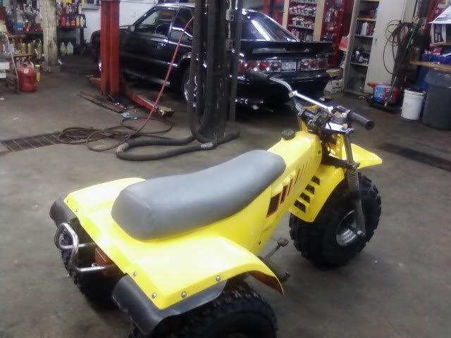

I am new to this fourm and I am wondering the best and cheapest way for me to clean my plastics

First wipe it down with some acetone or alcohol then wet sand it...start with 320 then 600 and finish it off with 1200 grit . Use a lot of water and keep the paper clean . Sand in 1 direction . Polish it up with some wax . It's a lot of work but your plastics will look like new

My old Tri-moto 175 after I wet sanded the plastics . They were all black and cruded up . Looked worse than yours . Wish I kept that it was fun to ride
