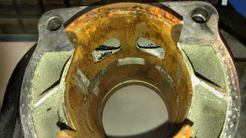

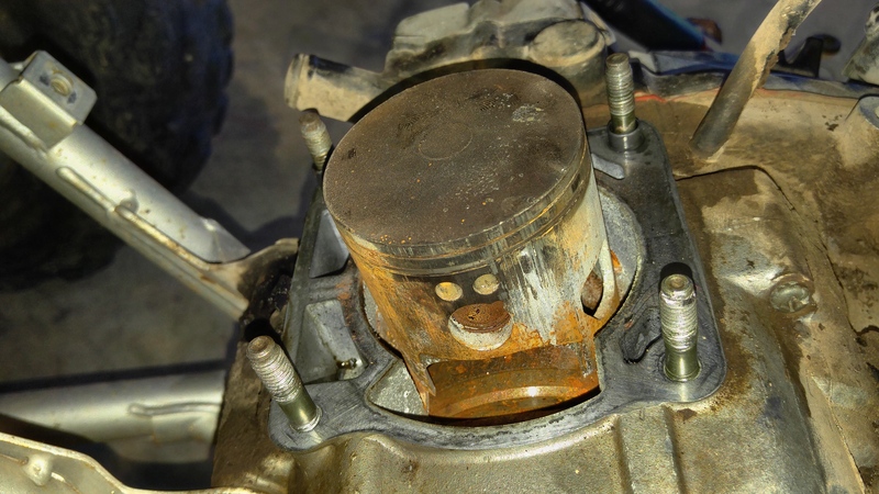

Top is torn off....and the bottom is locked up tight. Undecided on which way to go right now (rebuild bottom or get a new motor).
Warning...it's ugly inside.
It's ugly but we seen worse.. You can buy a new bottom end but there is more than enough info on the forum here as well as good people to help you out to rebuild it (most of it) yourself. That's if it needs a new bottom end but by the looks of the rust on the crank it probably does ? You will certainly need a new top end also. Piston, re bore/hone, top end bearing, pin, gaskets etc. If you were to buy a complete bottom end than you don't really know how much life is left in it. Re building your own is self satisfying and you know that everything is in spec and will last unlike a used bottom end that may be on its last leg..

I don't know what size piston I need yet. I'll be pulling the lower end out of the chassis this weekend to start tearing it apart. Then i can at least mic the piston & cylinder to figure out what size piston is in there and what size to go to.
I'm wondering though if the bottom end is fine. It used to rotate & turn. Once I get it out and get the piston off I'll dig deeper into it.
