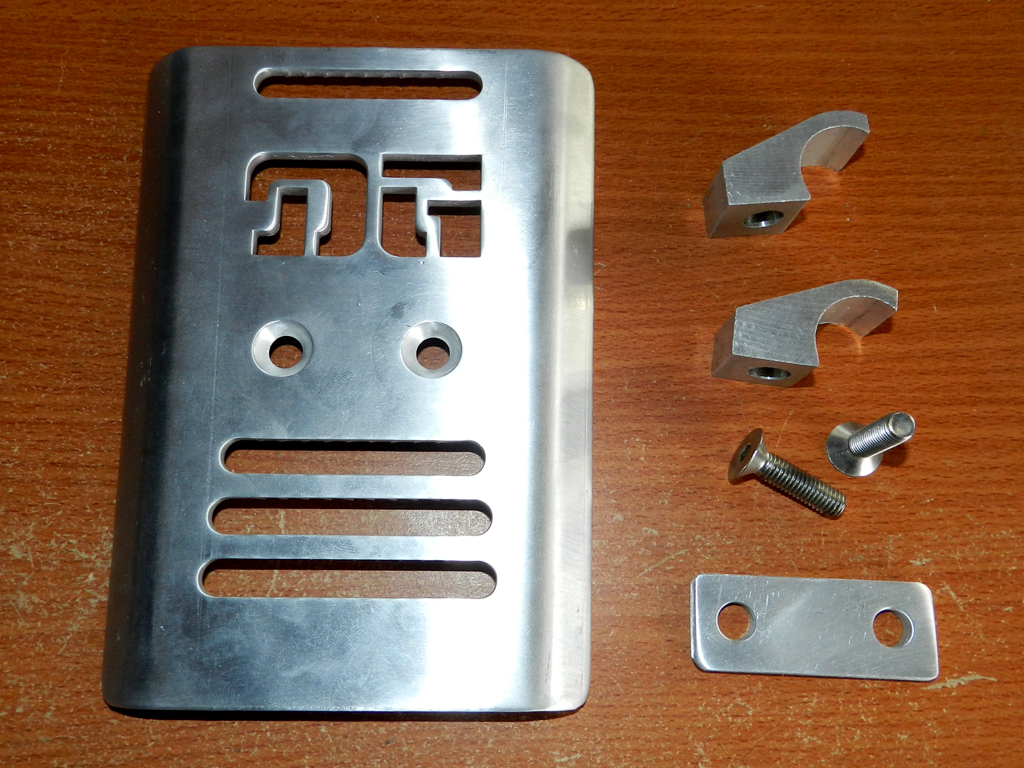

Photos of the DG Front Frame Guard.

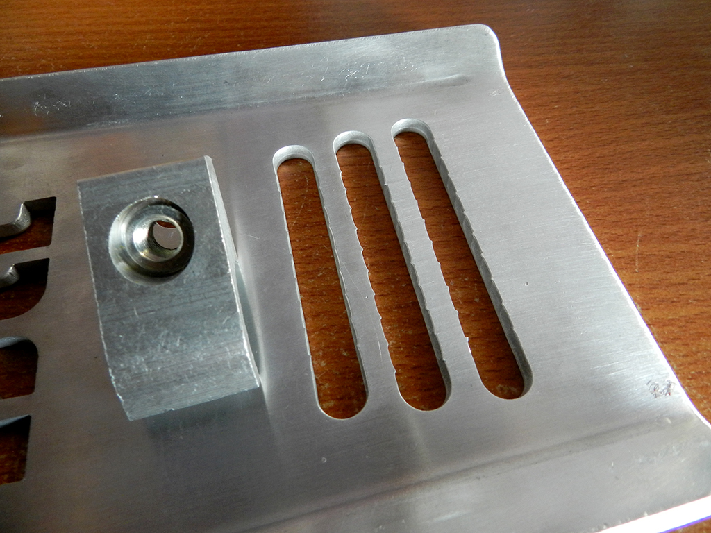

Quality is a bit low on the slotted holes. But the tube clamps are nice as they have a threaded insert press fitted in them and not just the aluminum threaded.

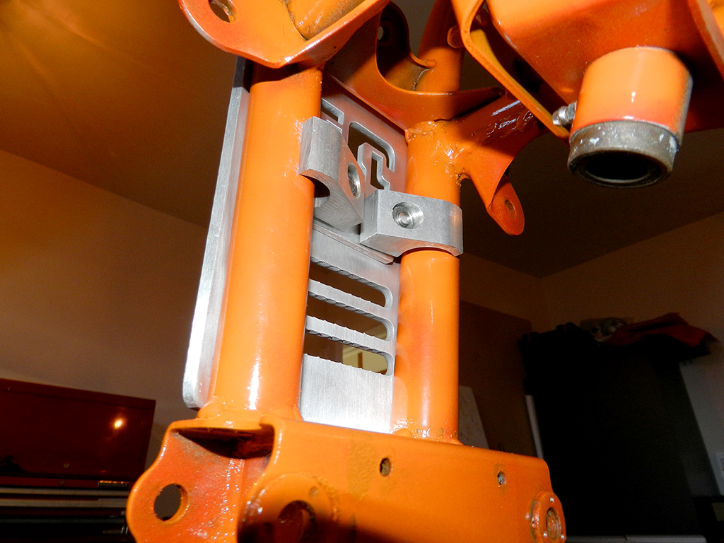

The guard sits on the frame nice.
But the clamps not that good. They fit 25mm tube but not the 28mm tube on this part. Also not 100% sure that the rectangle part goes where I have it. as its loss and rattles.
I already have a new idea on mounting it. Will take a photo of how the bumper fits with this guard on in a day or so.

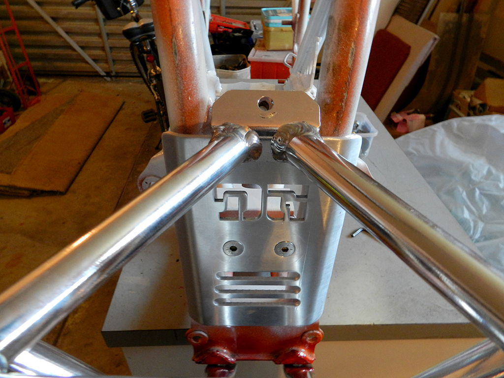

Here is a update on the front frame guard.
bumper will not fit with the DG guard installed.
So I cut out the top of the DG guard to make the bumper fit.
How I ended up mounting the DG guard was I installed a bracket in the frame. Not using stock mounts you get with it.
Finished.
