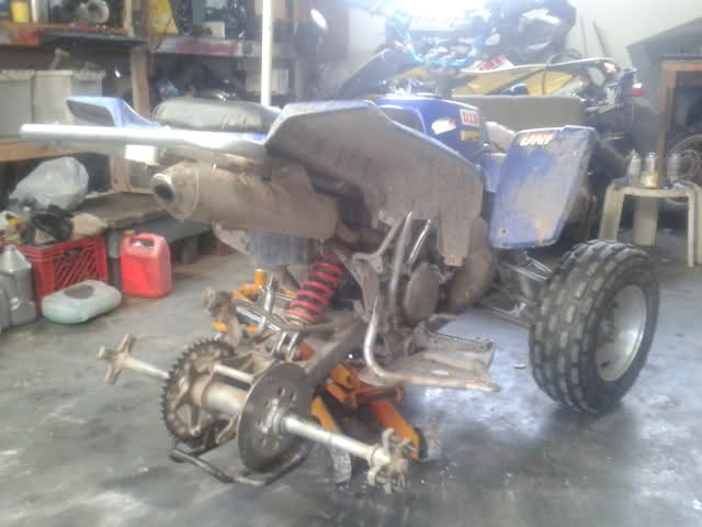

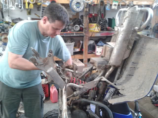

finally talked him into it :D extending the swingarm on the sx250blaster we figured 2in would be best. not to intrested in making a long or wide setup at all just a small attempt at keepin the front down.
who needs a jack!!

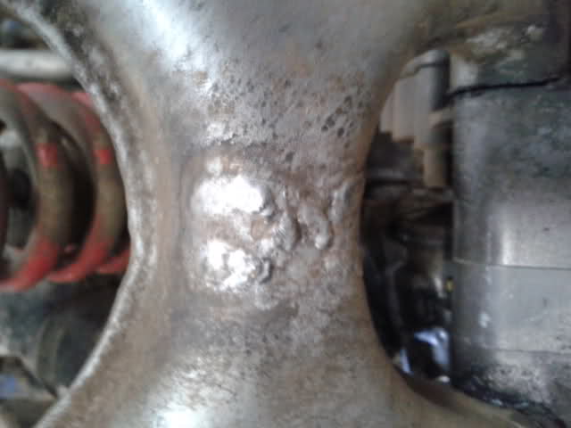

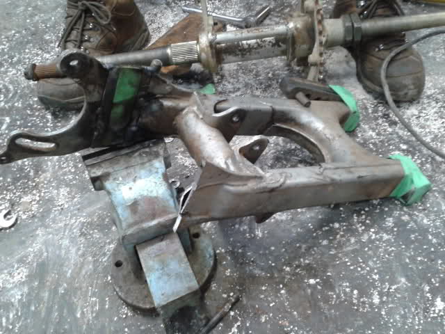

crack repaired back when bike was built, looks good
mr. Best

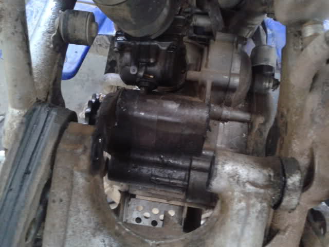

this swingarm has already been modded to fit the motor

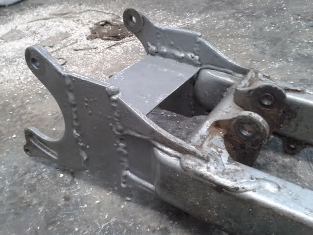

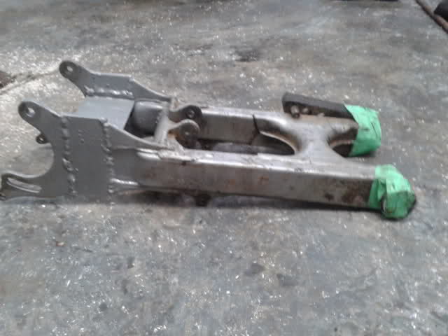

1/4" x 2" mild steel, about 4" long. Weld is a bit rough looking, it was done in short left and right stitches to avoid twist.
Put a 1/8" horizontal brace inside it to get rid of any side to side bend. Should be good in all other axis.
Added weight: about 1 pound
Cost: $3 for the steel and a dozen rods for my old 1950s Forney stick welder.

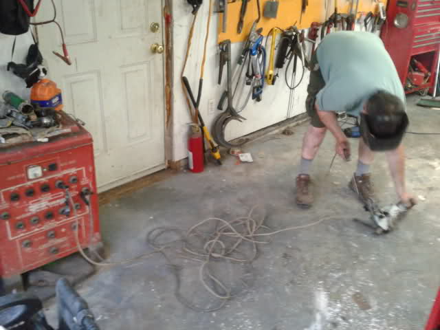

You can avoid distortion and twist by backstepping the weld.
Weld an inch of the weld to the finish point, weld the next run for an inch to the starting point of the first weld, and repeat until all welding is done.
Just gotta give you some green.
Not a bad job. Welds look pretty ugly but look like they will hold up fine. We call them gorilla welds; Ugly but tough as hell!

That is just what I did Blaaster, backstep the weld, so it is a series of stops and starts rather than a continuous weld.
Continuous weld would have been prettier, but I didn't have it jigged, just lightly tacked.
It is all in distribution, making the heat do the work by expansion and contraction.
Looks are not everything, it is all in the penetration. (What a sig quote )
I have one where a mod like this was started. It's not how I would personally choose to do it, but it will work.
my biggest concern would be if it got too much side bite in a corner that it could bend it sideways
I like the idea of not messing with the shock mount. I do at some point plan on extending a swinger myself, but I haven't decided what length to go. The other issue is any extention I may not be able to get both quads on the trailer. Getting a larger trailer isn't the answer either , the Bonneville doesn't like the 4X8 now! :p
Did you bevel the ends of the plates and the ends of the swingarm before you welded them together?? Did you clean the paint off the swingarm where you welded it??
If done properly this can be a easy and light weight whey to extend a swingarm. If it was me i would weld some plates on the sides on the top and bottom on both sides of the swingarm... Or maybe some angle or some kind of gusset in the inside.. The only problem is the lack of room you have to work with because you have to have room for the carrier.

Beveled the sides, not the ends, and I burnt it in real good. That is why I used the stick in small stitches.
Well, I thought about just exactly what you suggest but weight out at the end of the swingarm is an issue for me.
The 1/4" steel is plenty strong in all axis except the side bending that many have suggested.
Boxing it may be a good idea, but if my figures are right, the 1/8" plate brace should be enough.

I didn't want this any heavier than necessary and I have it figured this should be just strong enough to do the job.
No over kill, no excess weight.
I'll test it pretty hard to see if it comes loose, hopefully it will give some warning, cracks, bends etc.
I'll report it if there is a problem so we all know, and there is room for more diagonal bracing if you want to do it.
So how's it work? Pretty good so far!
Still lofts easily even on grass and I gave it the the old wood pile test, you know? Drive over the wood pile?
Yeah Shaun, that one there...
The beauty of this extension is that it is very easy to line up without a jig.
The cut is straight forward, the 5 inches of weld in 1/4" steel is easy to get right.
The cut and the plate are the same thickness on both sides. Line up the bottom edges. Get it straight.

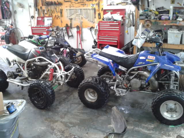

looks sweeet, yes the tires are backwards but its for a better attempt at traction from the used tires.
just the extra couple in's changed the whole feeling of the bike. i tested it myself and it feels SWEEET. the bike has no problem kicking side ways and exiting pulling smooth wheelies much more controlled.
