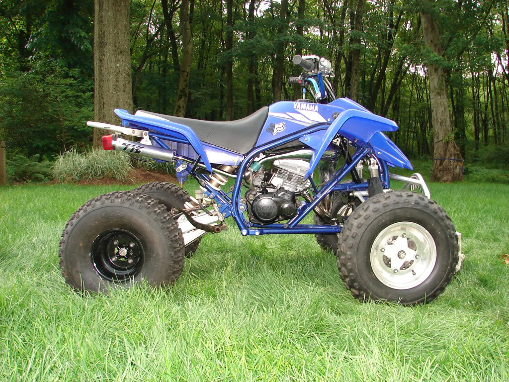

A Arms: Stock
Swingarm: Stock
Steering Stem: Stock extended
Stabilizer: none
Axle : stock +4
Carrier: stock
Locknut: stock
Hubs F|R: stock
Bars: MSR
Throttle/Clutch Lever: stock
Grips: Scott
Nerfs: tusk
Bumper: tusk
Grab Bar: custom
Front Shocks: works dual rate
Rear Shock: 400ex
Brake Lines: stock
Rotors F|R: Cross Drilled
Rims F|R: stock
Tires F|R: Artrax MXT-r
Body: Cut
Frame: 01
Plastic: cut
Graphics|Seat Cover: stickers/none
Number Backgrounds: white
Handguards: none
Bar Pad: renthal
Fuel Tank: stock
Engine|Drive System:
Cylinder|Head: stock
Bore & Stroke: .10/stock
Displacement: 197cc
Cam: ummm?
Carburetor: stock
Air Filter|Box: UNI/no lid
Pipe|Silencer: fmf Gnarly/FMF PC2
Clutch|Plates: tusk
Gearing F|R: 13/40
CDI|Killswitch: stock/tusk
Cooling: air
Other: SCD Porting, SCD Head Rechamberd, Boysen Power reeds, fliped front wheels.

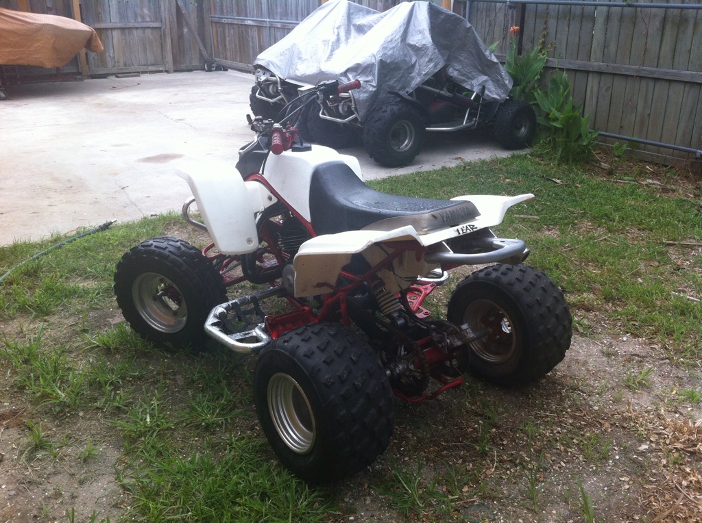

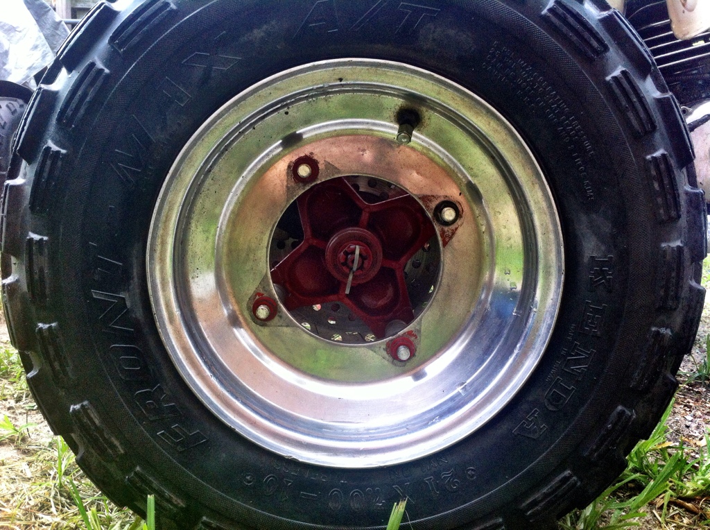

A Arms: painted stock
Swingarm: painted stock
Steering Stem: stock extended
Stabilizer: none
Axle : painted stock
Carrier: painted stock
Locknut: stock
Hubs F|R: painted/banshee
Bars: renthal
Throttle/Clutch Lever: stock/evs breakaway
Grips: scott
Nerfs: none
Bumper: stock
Grab Bar: custom fabbed
Front Shocks: painted SIE air shocks
Rear Shock: stock
Brake Lines: stock
Rotors F|R: stock/stock
Rims F|R: flipped/itp
Tires F|R: innova
Body: stock
Frame: shaved extra mounts
Plastic: stock
Graphics|Seat Cover: stickers/ custom
Number Backgrounds: none
Handguards: tusk
Bar Pad: none
Fuel Tank: stock
Cylinder|Head: vitos bbk. kor head mod and porting
Bore & Stroke: 72mm/stock
Displacement: 240cc
Cam: whaaaaat??
Carburetor: stock tors delete
Air Filter|Box: uni/no lid
Pipe|Silencer:
Clutch|Plates: toomey B1/ pro circuit 304
Gearing F|R: 14/40
CDI|Killswitch: stock/stock
Cooling: air
Other: oil injection delete,stripped wiring harness,painted everything

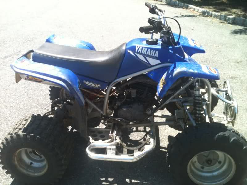

A Arms: stock
Swingarm: stock
Stabilizer: stock
Axle : stock
Carrier: stock
Locknut: stock
Hubs F|R: stock
Bars: protaper
Grips: spider
Nerfs: tusk
Bumper: blingstar
Grab Bar: stock
Front Shocks: stock
Rear Shock: stock
Brake Lines: stock
Rotors F|R: stock
Rims F|R: stock
Tires F|R: 20inch rear kenda klaws
Body:
Frame: stock
Plastic: maier front
Handguards: none
Bar Pad: protaper
Fuel Tank: stock
Bore & Stroke: stock
Displacement: 195cc
Cam:
Carburetor: stock
Air Filter|Box: stock
Pipe|Silencer: stock
Clutch|Plates: stock
Gearing F|R: stock
Cooling: air
Other: custom lights

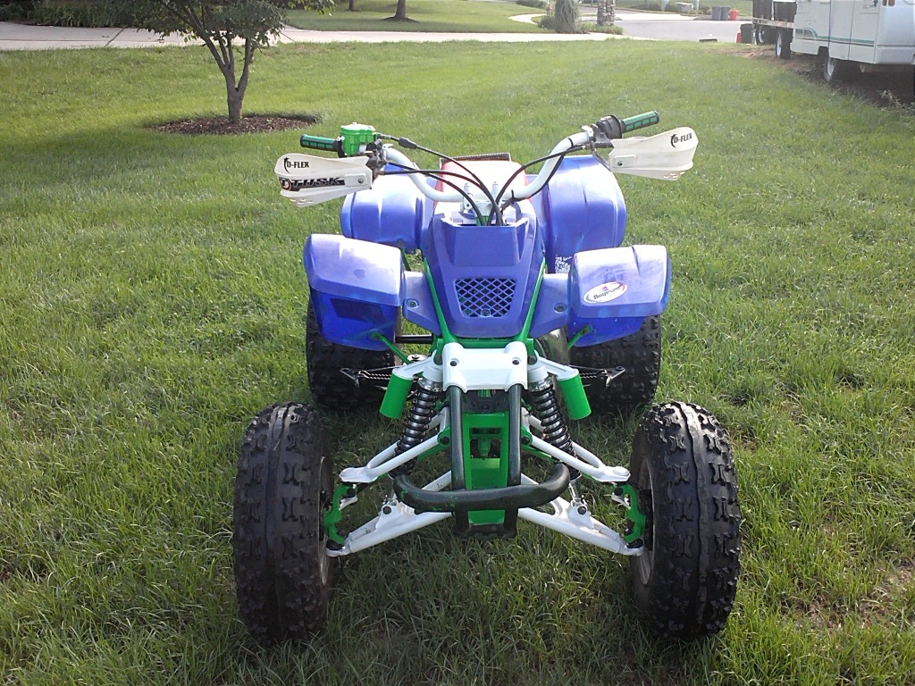

A Arms: stock- painted-single stage
Swingarm:stock- painted-single stage
Steering Stem:stock- painted-single stage
Stabilizer:none
Axle :stock painted-single stage
Carrier:stock painted-single stage
Locknut:stock
Hubs F|R:banshee painted-single stage
Bars:bmx painted
Throttle/Clutch Lever:tusk
Grips: oury red
Nerfs:tusk comp series
Bumper: tusk
Grab Bar: dg fat
Front Shocks: stock (works otw)
Rear Shock:stock
Brake Lines:stock
Rotors F|R:stock
Rims F|R:front- douglas fronts / itp baja rears
Tires F|R:kenda front max and holeshots
Body:
Frame:stock sexy painted single stage
Plastic:stock
Graphics|Seat Cover:stock
Number Backgrounds:stock
Handguards:none
Bar Pad:none
Fuel Tank:stock
Cylinder|HeadIY ported
Bore & Stroke:80 over and stock stroke
Displacement:205cc?
Cam:are you surious?
Carburetor:mikuni vm26
Air Filter|Box:uni filter stock box
Pipe|Silencer:fmf sst pipe and silencer
Clutch|Plates:heavy duty clutch
Gearing F|R:13/40
CDI|Killswitch:stock
Cooling:stock
Other:sexy
