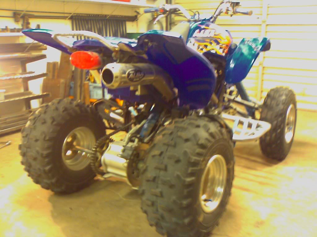

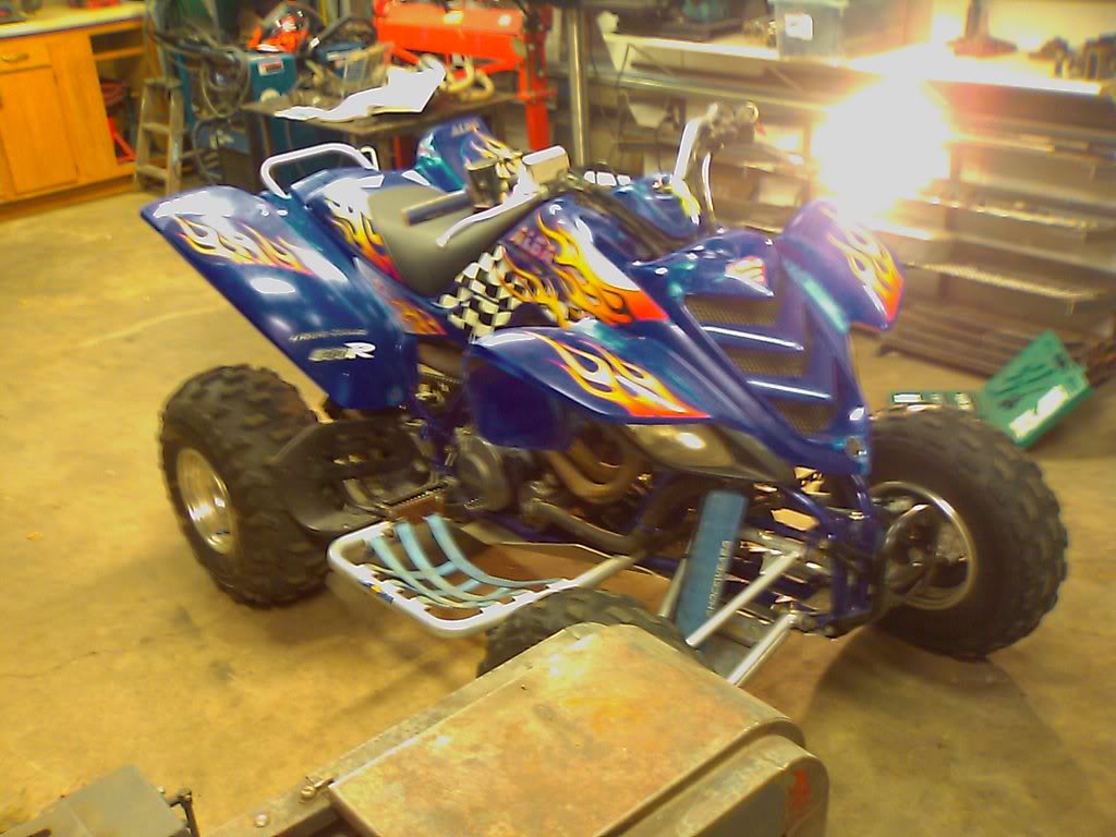

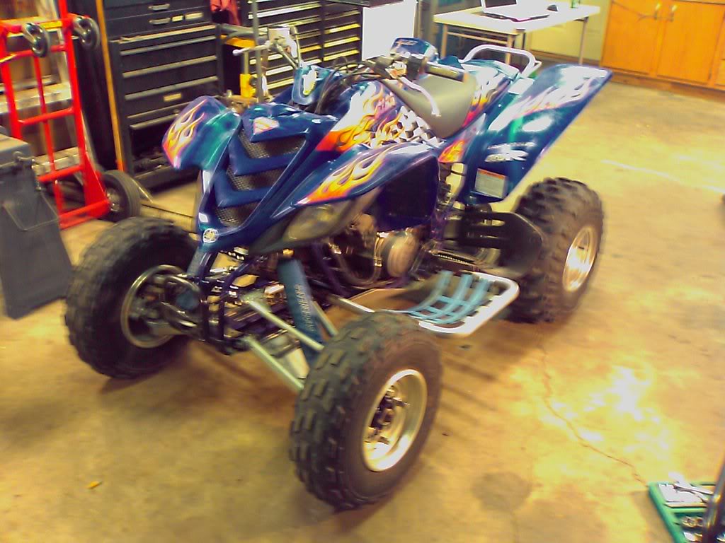

Well, I went to check it out, verified it as an 02 from the VIN. The plastics are a little rough, but it was only second gear that was slipping out, and you could get to reverse without using the aftermarket handlebar mounted lever, BAD!
Besides that, she ran hard, and popped up the front end real easy, all I had to ride it on was a gravel road, and it was squirly through all the gears. My neighbor friend ended up knowing the guy, and he is mechanically challenged...lol...His friend from our tech school here did the motor work, and instead of a big bore (could be still, but ?), I believe it to be an ALBA stage 2 kit (piston dont know what size), and cam, and also pipe.
He seemed like an honest guy, and my friend knew him, and if the kit is not in there, oh well, she still goes like hell (fast enough to spook my buddy when he rode it!)
I talked him to $1250, because of the issue, he is moving and going to school, and has bills to be paid, he needed the money. I thought it was a good deal. If all else fails, I can part it out for that!
When I got home, I fixed the Reverse issue, the lever on the motor was loose on the shaft, and the bolt was loose, put it back on, tightened, and that was fixed. Works only when reverse lever is used.
Now for the tranny, If I have to split it, so be it (i think it might just be second is worn out), but im going to take the cover off first and inspect the shift shaft, springs, etc and see if its all ok.
I am busy till sunday night or monday, so I cant inspect further, but then the side cover is coming off, and if nothing there, then removal and splitting the motor.
